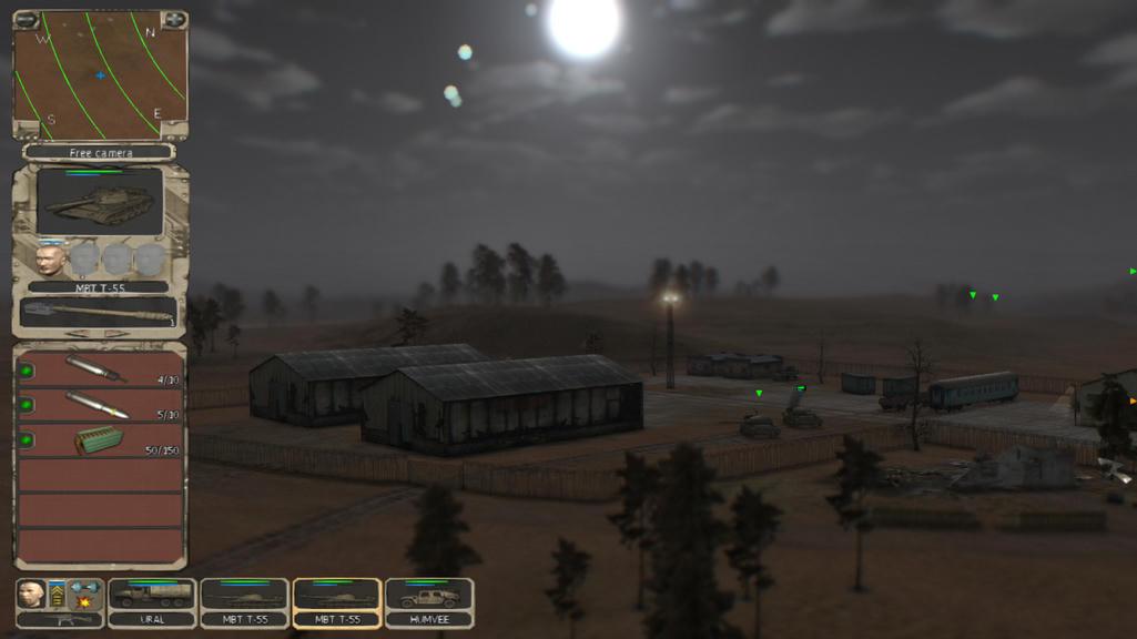

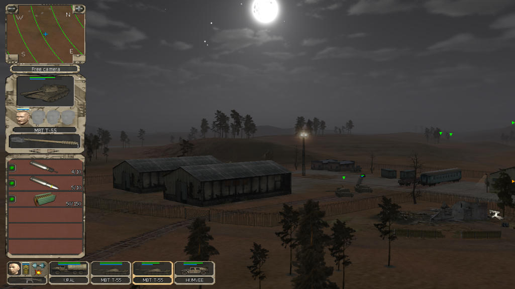

Would that be possible to check why mouses with high pooling rates have issues with dgVoodoo? For example, in Aliens vs Predator 2 (LithTech) everything works fine only with 125Hz pooling rate. The higher the rate the more choppy the games becomes. And it only happens with dgVoodoo, native works fine.
Reply 417 of 1111, by djc5166
WSH303 wrote:
Hello,
I've seen this even with modern games, setting 1000hz in my logitech panel makes some games entirely broken. Probably just has to do with when/where the mouse is read.
Reply 418 of 1111, by Dege
szabozadam wrote:
Sorry to bother you, the fix regarding Soldiers of Anarchy is only half good the game still makes dgVoodoo lose the light part o […]
Dege wrote:
Things are going slowly nowadays so I share a little WIP compiled from the branch of 2.55 (I want some more fixes in the patch version though):
Sorry to bother you, the fix regarding Soldiers of Anarchy is only half good the game still makes dgVoodoo lose the light part of the stateblock when you move the camera (I think the actual trigger is a new mesh being added to the scene as a result of frustum culling but that is just speculation)
Here is a demo with WIP45 or WIP46:
https://www.youtube.com/watch?v=2cMQxBYOafI
Could you attach the .mis file you're loading in the video, plz?
I tried with several other but couldn't reproduce it. Or maybe I'm using a different version of the game? (some patch is not installed or sg)
Reply 419 of 1111, by szabozadam
Ah I see, the difference in our setups should be the shadow setting (the issue was independent of the .mis file, and the exe version on my end), I just realised that you can only enable shadows with the options menu outside the game (you should be able to open the menu if you run the exe from a cmd like:
soa -o
) there is a "Shadow detail" option (on/off) in the options tree on the left which I enabled but had forgotten I did.
It become a nonissue though as without shadows the lighting works as it should and it seems this feature was so unfinished the ingame menu can't even be used to enable it (I didn't experience any natively (years and years ago on an era appropriate pc) but it is entirely possible that the shadow rendering has/had glitches as a result of this state of incompleteness and should be kept disabled, nevertheless the current(win8.1 "current") default windows supplied ddraw.dll manages them somehow so for the sake of completeness it may be worth looking into (if indeed I'm correct and enabling shadows will mess up the stateblocks on your end aswell) but that is your call)
Thanks for taking a look though, helped me figure I should test the possible settings again 😀
