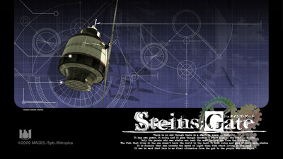

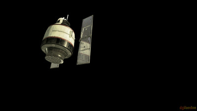

Steins;Gate Steam version:
Something wrong, here's how the title screen should look (DXVK):
It needs hex edit to change d3d9.dll to v3d9.dll to work with dgVoodoo/DXVK at all.
Edit: never mind, debug log told me the reason: it was out of VRAM. Not something I expected of a 1080p 2D game. And I would have expected it to crash, not do that.
Lanczos upscaling makes the game look marginally better, but it has the double cursor problem.

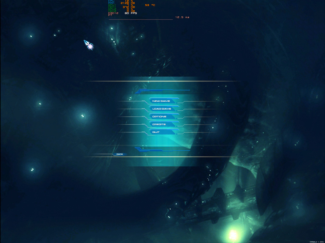

Bad mouse lag in Unreal 2 menu using the frame limiter (80 FPS).
Just starting the game, NOT pausing it.
UT 2004 input too feels "strange" (in both game scaling set to "centered", to play @1920x1440)

Input lag with the limiter ON got a massive enhancement BUT the input still feels strange sometimes, it's like having a sensibility threshold....
Unreal 2 menu is really perfect to test this issue.
Reply 439 of 474, by lowenz
What problem? The input lag? No, it's not related to dgVoodoo2, it's related to the dgVoodoo2's new LIMITER. With no limiter enabled there's no issue and it's stated in the 2.74.1 changelog that use of d3d12+limiter can cause some lag.
