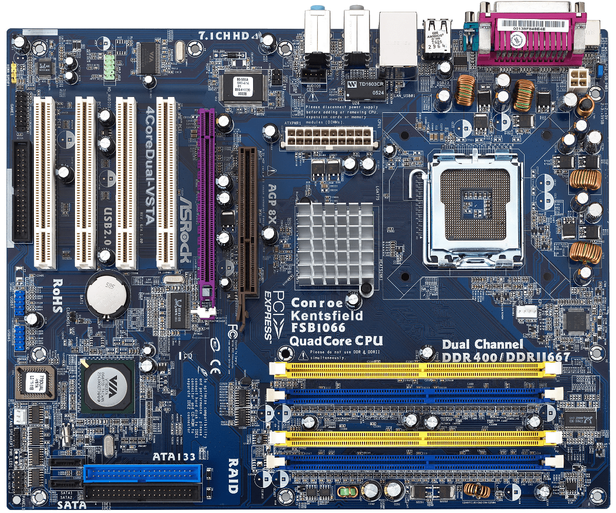

Reply 450 of 871, by Zoomer
Has anybody tried putting quad core (e.g. QX9650) intro 775dual-vsta with modified bios 3.19a? Will it take a quad core at all with such a BIOS? I can't seem to find specifics about differences between 775dual and 4coredual (not SATA2). Only that they're 'really' similar. And that I maybe have to replace 775dual bios with 4coredual bios (?!). Could someone please shed some light on that matter?
Edit: funny thing. If you open 775dual-VSTA's photo and 4coredual's photo from Asrock's site - they're pixel-per-pixel identical except printed text - and even there some parts of it are totally the same. That can't be right. Must be photoshopped. Check that out!
https://www.asrock.com/mb/photo/4CoreDual-VSTA(L1).png
https://www.asrock.com/mb/photo/775Dual-VSTA(L1).png

Reply 451 of 871, by The Serpent Rider
They are identical, the difference is only in PLL. Modified BIOS should work too.
