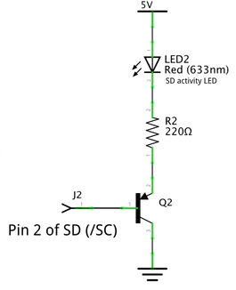

Reply 509 of 671, by Aaron707
Eivind wrote on 2023-04-21, 19:44:
I've been looking into that myself. Unfortunately I haven't found any good solution, don't think there's any purpose-made soluti […]
Aaron707 wrote on 2023-04-21, 19:27:
On the TinyLlama, and Vortex86EX, is it possible to have a disk activity LED? I looked at the schematics for the SOM and didn't see anything. Unsure if anything can be mapped to unused pin for that purpose. Thanks
I've been looking into that myself. Unfortunately I haven't found any good solution, don't think there's any purpose-made solution at least. No ready-to-go pin one could bring out through the crossbar.
For the SD card, I guess one could hook a mosfet gate onto one of the data lines or something, and use that to drive a led. No idea how that would turn out... 😀
Another way could be to modify the BIOS to do something on data reads/writes. The EX has the ability to use some of its pins as GPIOs, but I've been using all of its port groups for other purposes (ISA mostly).
Open to suggestions!
Thank you for the idea. I think I will try the diagram here: https://hackaday.io/project/12782-orange-pi-p … -and-status-led
Looks like a PNP transistor on pin-2 of the SD card slot might do it. When the 5v signal goes low on the base it will trigger the LED. I will get a BC557 PNP transistor to try next week.

Aaron707 wrote on 2023-04-22, 00:23:
Cool, give it a shot! Just a couple of things to be aware of - first, it looks like that article talks about the MicroSD card being used in SPI mode, where pin 2 is the CS signal. The Vortex86EX runs the SD card in "SD mode", where pin 2 is DAT3. I dunno if this is the best signal to use as an activity indicator, maybe it would be better to use pin 3 (CMD). You could try experimenting and see which one works best?
Second, it's good practice to add a resistor between the signal and the base of the transistor, as not to let too much current pass through and mess with the signal. Not sure it's absolutely needed in this case, but better to be safe than sorry. Try searching for some kind of transistor calculator online to figure out the best resistor value for driving the led (as high a resistance as possible while low enough to properly open the base-collector path of the transistor).

Reply 514 of 671, by RayeR
Eivind wrote on 2023-04-22, 00:13:
2 of the USB ports go straight to the CH559 chip which runs rasteri's "HIDman" firmware which translates USB HID devices into keyboard and mouse PS/2 signals. This works way better than letting SeaBIOS do the PS/2 emulation.
Aha, I didn't get a CH559 yet... How the FW is programmed in? From vortex or ext. Tool? I would be fine with native PS/2 double miniDIN as I have a plenty of old kbd & mice...
Using SD CS# signal is also good idea, instead PNP I would use P-MOSFET without need of base resistor.
