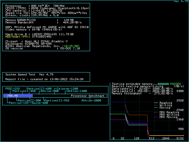

About a month ago, a batch of three AMD K6-2+ 570 MHz (570ACZ) from a well known seller finally arrived. I prepared my trusty Gigabyte GA-5AA (cache stable at 115 MHz FSB), nice cooler with a copper core and began. First I quickly confirmed that each is capable of 600 MHz @ 2.0V - this was no problem. Then I set 2.2V to check maximal OC potential. One of the CPUs (#3) was able to load Windows at 690 MHz and seemed stable:
14.84 KiB
2281 views
6.31 KiB
2281 views

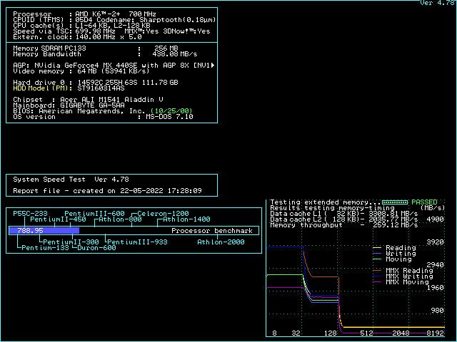

Unfortunately Prime95 quickly showed an instability. At that point I said "OK, let's see, what 2.4V can do!". With this voltage I didn't want to torture this CPU in Prime, so I just tried how far can I go. At 720 MHz (6x120 with disabled L3), computer went through POST, but even DOS applications were crashing. As a final resort I tried combination 700 MHz (5x140 with disabled L3) which seemed stable in DOS and this is where I took this:
7.71 KiB
2281 views
But Windows was a no-go. Funny thing is, I confirmed later that 140 MHz FSB is unstable even without cache, so for 700 MHz Windows "experience" I would need a better board.

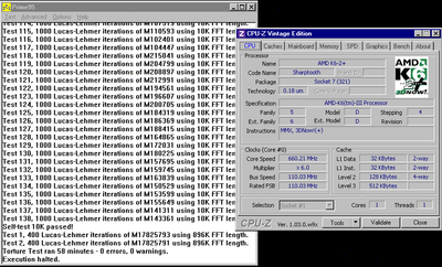

Finally I wanted to check how far can I go at a standard 2.0V. To my great surprise it was 660 MHz (6x110):
35.97 KiB
2281 views

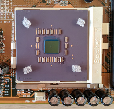

Yesterday, I finally decided to go with the mod for the best CPU (#3) in the batch. After de-lidding, some cleaning (btw. plastic eraser is great for scrubbing the remnants of TIM from CPU) and de/re-soldering of the link (here I am not sure if it's a 0 Ohm link or a capacitor because my measurement showed 32 pF of capacity) the deed was finally done (sorry, no time for cleaning 😀):
268.32 KiB
2274 views
I didn't want to waste time with re-attaching of heatspreader so I went ahead carefully with on die cooling. During the first POST, I was holding my breath, but there were no cache errors! Then I used memtest as per guide to test the cache properly and everything was OK. After that I basically confirmed what I have tested before: 700 MHz @ 2.4V is still highly unstable (as I wrote, here I would blame the board), 690 MHz @ 2.2V is still Prime95 unstable, but more importantly 660 MHz @ 2.0V is still stable. I went as far as to lower the voltage to 1.9V and it still managed to do over an hour of Prime95 without any issue:

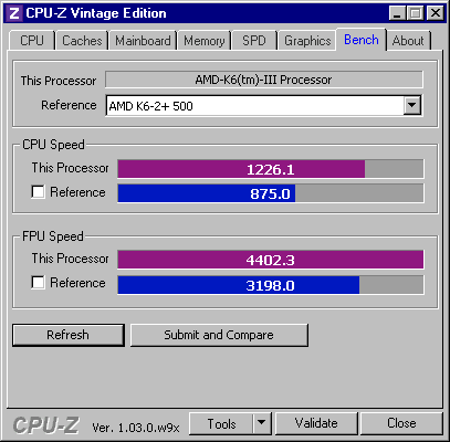

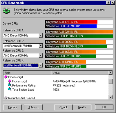

A few more pictures of unstable 690 MHz @ 2.2V:
14.74 KiB
2274 views
6.48 KiB
2274 views
21.43 KiB
2274 views
