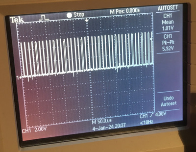

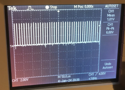

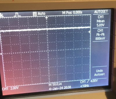

Reply 74 of 82, by perezx
Oh, thank you so much and, of course, Merry Christmas and Happy New Year!
I was quite busy with a bit bigger machine (particle accelerator, which doesnt want to work too) but never forgot about the laptop's PSU.
Now I spent couple hours looking for some patterns in how does it start.
Well, I still do not understand for what reason it tries (or not - 50/50 chance) to produce PWM at the very power-on (before ptressing the button), but at least in some cases the signal at pin34 IC 13 looks like pic.1 Good enough?
Then in couple milliseconds it comes to DC 5V and stays so for 3-4 seconds (pic.2 ) until IC12 removes 5v_B from IC13. If the button pressed within these seconds (while 5V_B still high) - no PWM and LED starts blinking.
If the button is pressed after 5v_B is down, then 100% chance of getting one more attempt to start 18V PWM as on pic.3.
Looks like normal logic for CPU? I guess I should trace this PWM signal further thru the gate and FETs (however, I've checked all the FETs out of board)

    Pic. 2. PWM cancelled
    955.15 KiB
    483 views
    Pic. 1. Power just plugged in, IC 13 produces PWM
Reply 75 of 82, by FuST
Those PWM signals look normal to me.
The blinking LED when trying to re-power the board is something I encountered as well. You have to wait for the 5V_B rail to drop below TTL logic high (around 2V) but preferably 0V.
Makes testing and debugging a bit tedious as the capacitance on that rail means it can take up to 5 seconds before another attempt can be done.
Next check I would do is if the PWM makes it to Q29 and if any 18V comes up and regulates properly.
If so it's time to start checking the other PWM driver pins on the ICs, check the MOSFET gates, etc.

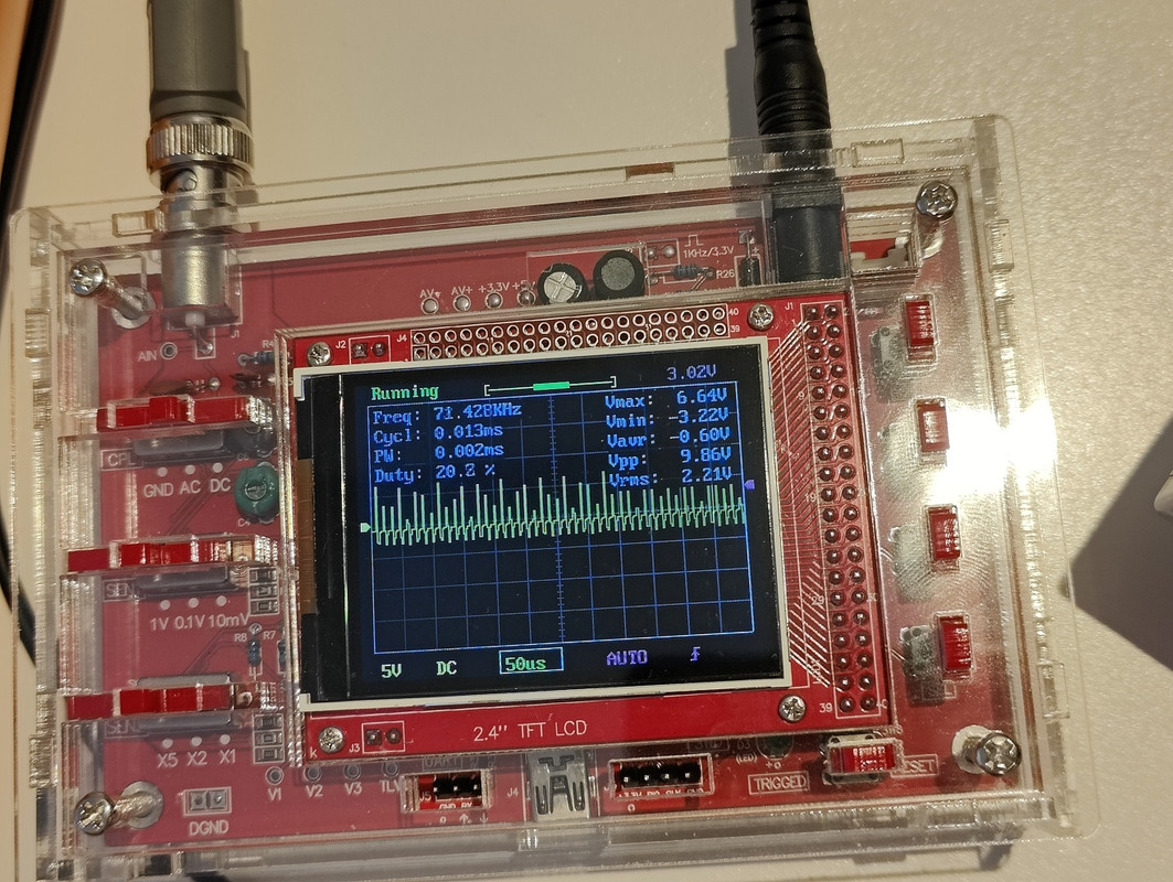

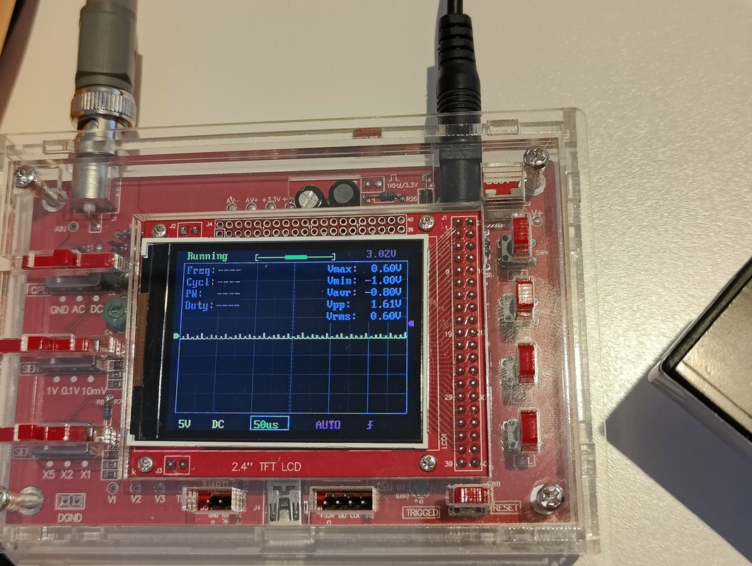

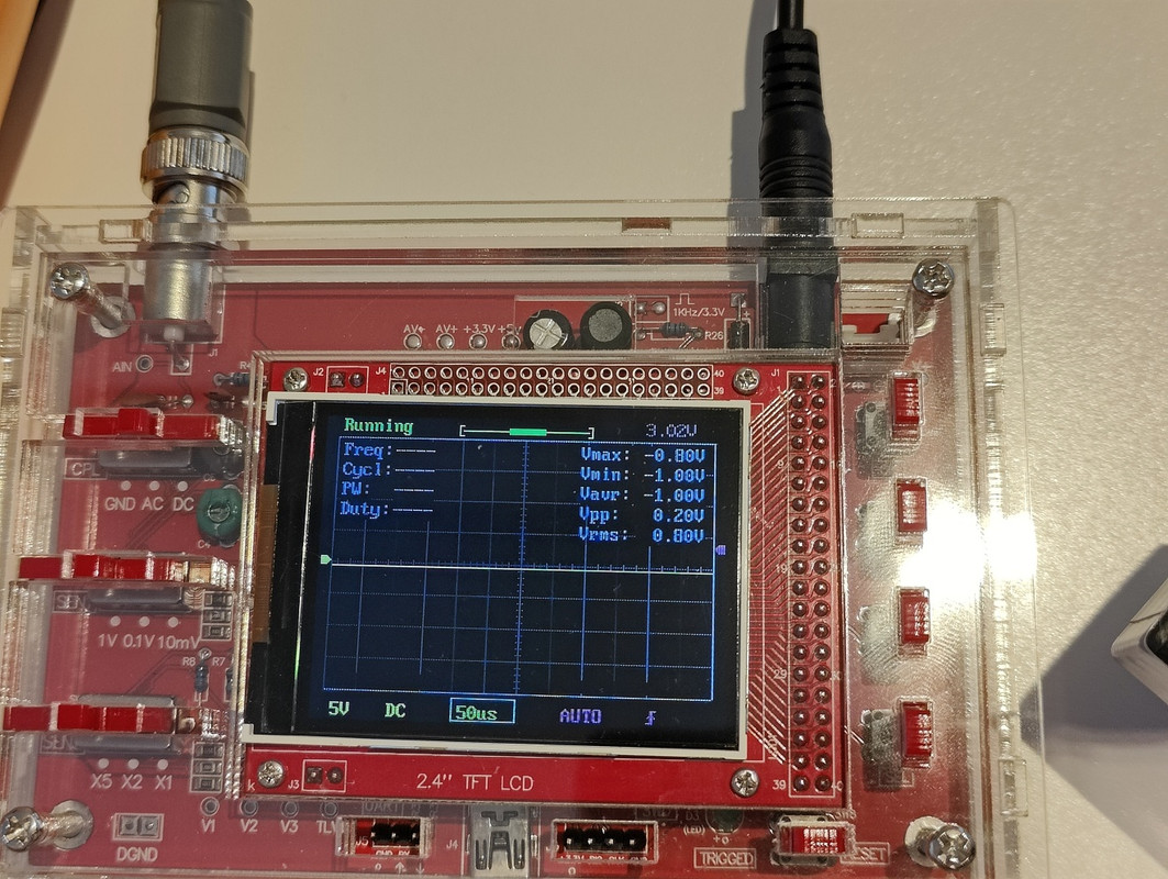

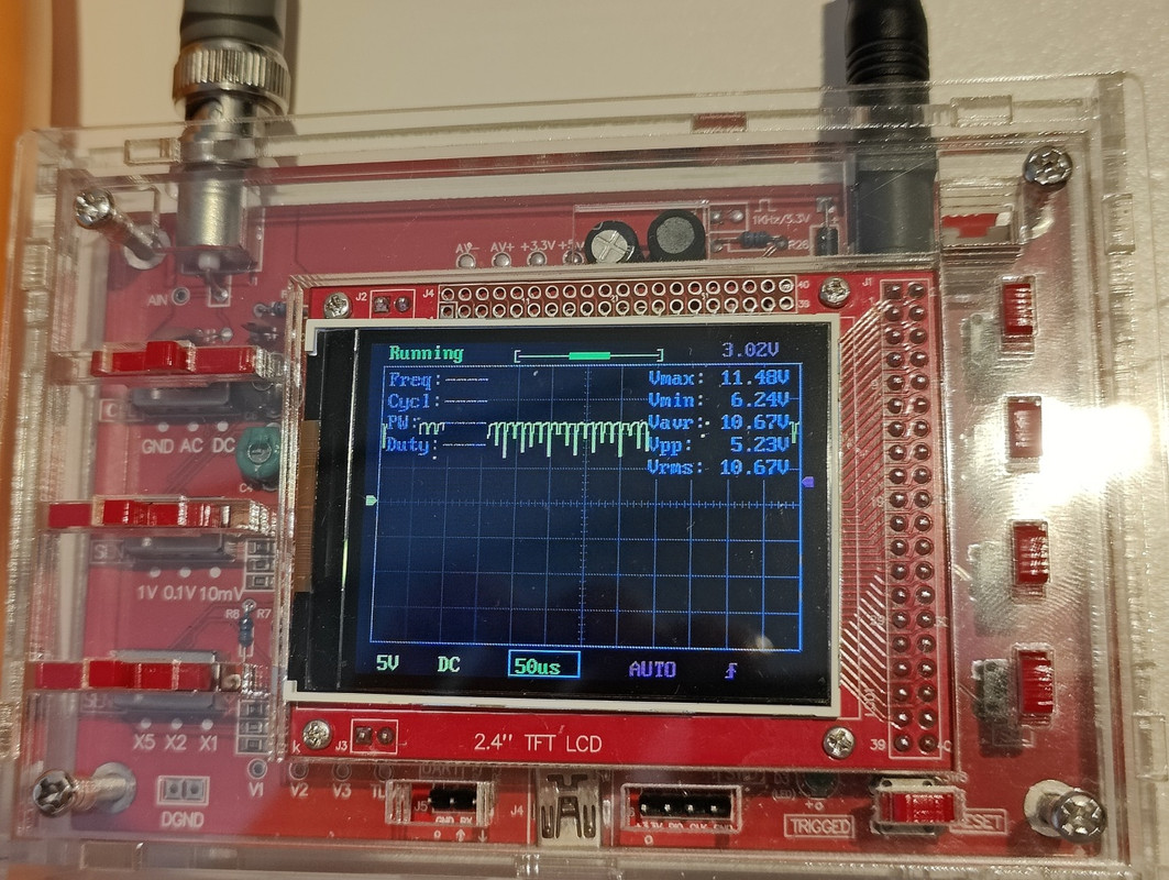

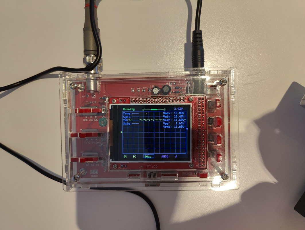

Reply 76 of 82, by miclass
Hi all,
I am also trying to repair 2 T1600 - one is in a very bad condition, so I started from the less rusty 😀. I did not try to switch it on and I directly substituted all caps, luckly there are no significant corrosions...now I am verifying if it works properly before reassemble it. When connected to its power adaptor, the offline voltages are fine, I get 12v on the Mosfets (Q14 Source, Q1 Drain, Q5 & Q6 Source, Q2 & Q3 Drain).

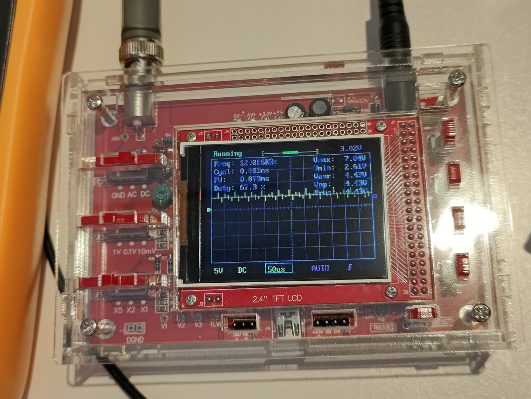

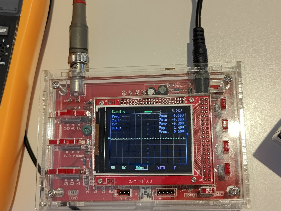

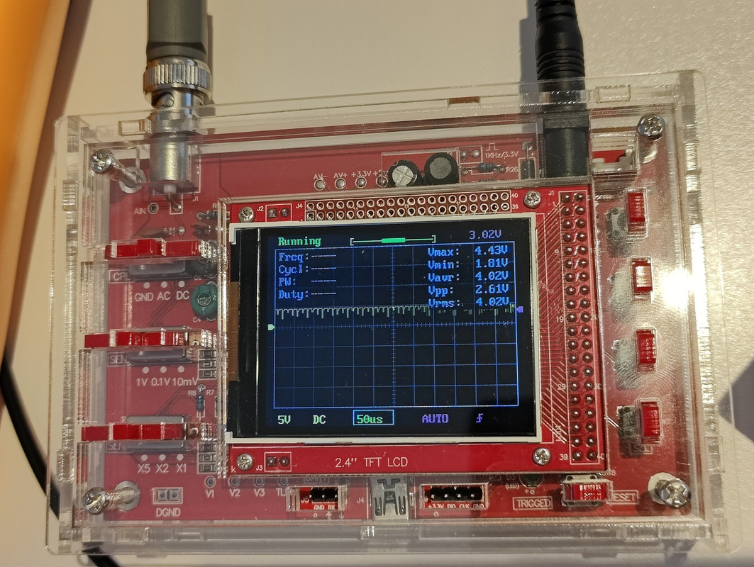

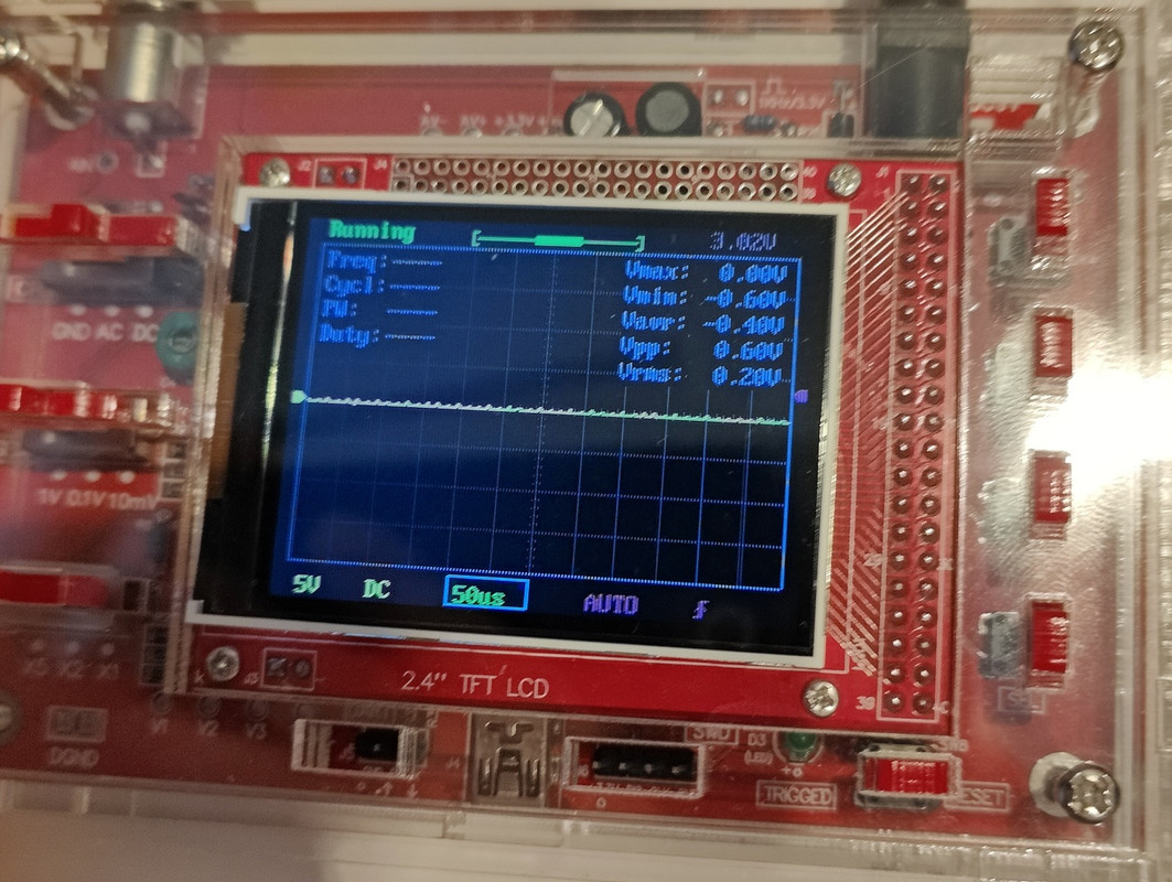

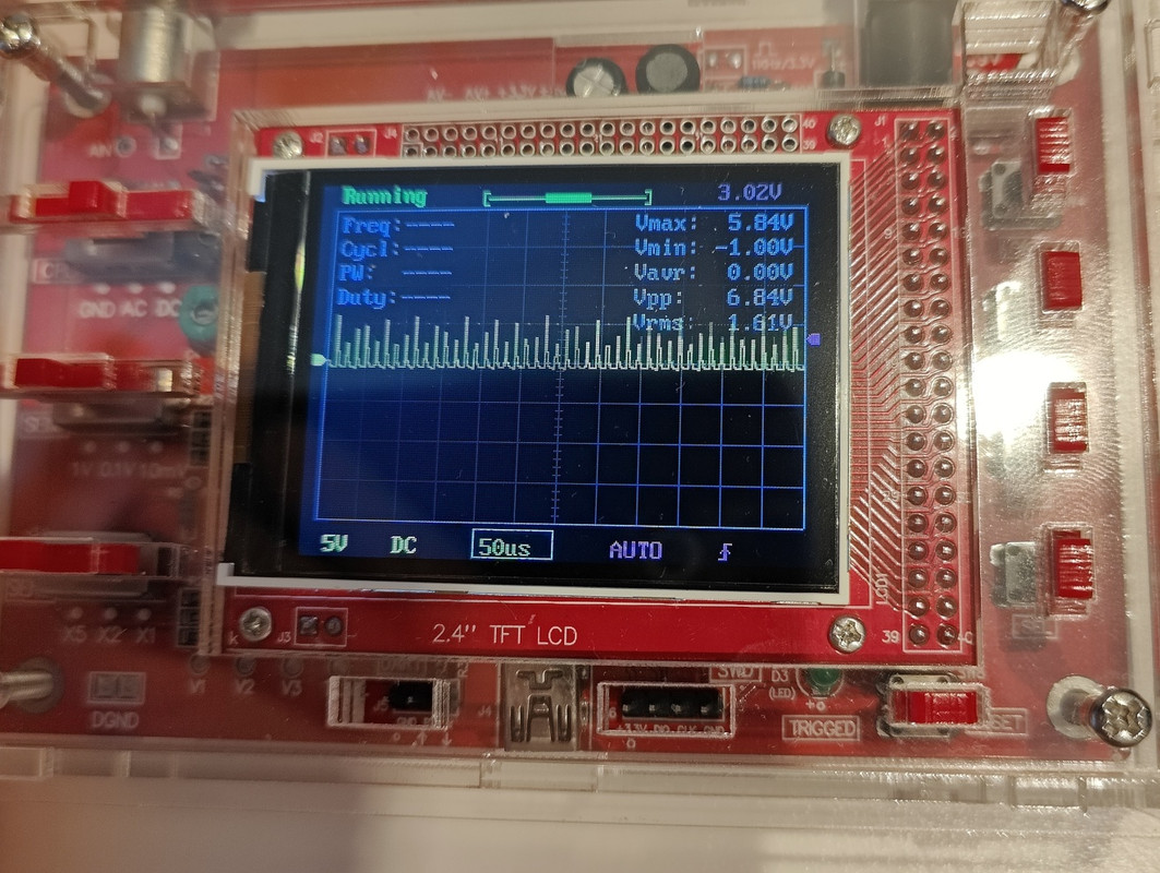

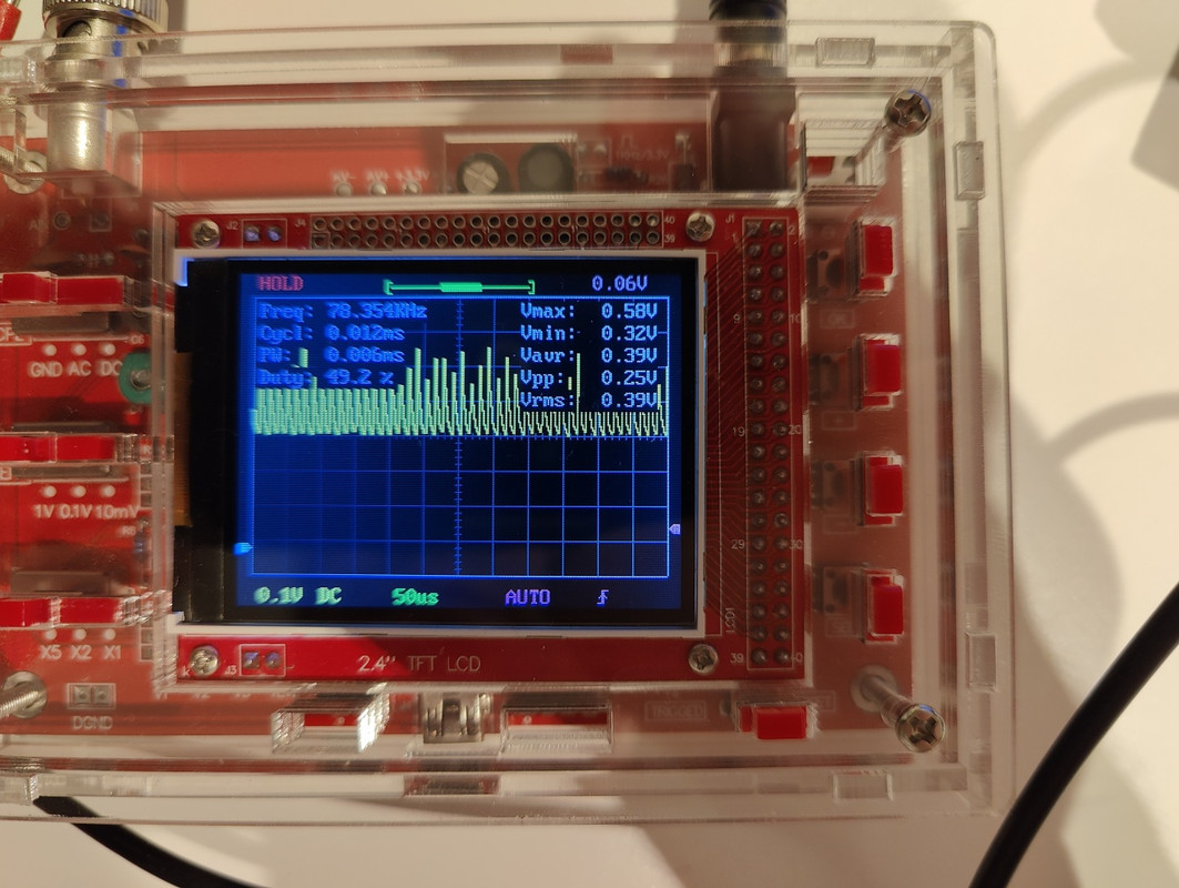

When switched on, the Led remains solid red, no blinking at all...so I checked the PWM signal at the Mosfets' gates. Q7, Q5 and Q6 look fine to me...but on Q4 gate I have no PWM, just a small fluctuation, almost 0v. I can measure 12v on Q4 gate when the PSU is off, but when I switch it on it goes to zero volts. I checked also all outputs of the Mosfets, again Q7, Q5 and Q6 look good, and on Q4 Drain I have 12v volts stable (the same on C3 positive) - does it make sense as I have no PWM on its Gate?
Considering this behaviour I checked Q23 base, also here I have 12v when the PSU is off and 0v when it's on. Then I checked IC5, UPA1600, here I have the same situation on the output pin 15 (PWM 12V): 12v when psu is off and almost 0v when it's on. I also checked the input (pin 6) and here the situation is different, I have 0v when the PSU is off and a PWM at 5v when it's on.
Could be the mosfet inside the IC5 UPA1600 broken? Any other options to consider? I add some picture to better explain the situation...
Thank you!
Q7 Gate - PSU ON
Q5 Gate - PSU ON
Q4 Gate - PSU ON
Q4 Drain - PSU ON
Q7 Source - PSU ON
Q5 Drain - PSU On
Q23 Base - PSU OFF
Q23 Base - PSU ON
IC5 UPA1600 - Pin15 P12V_PWM - PSU OFF
Ic5 UPA1600 - Pin15 P12V_PWM - PSU ON
IC5 UPA1600 - Pin6 P12V_PWM_DRV - PSU OFF
IC5 UPA1600 - Pin6 P12V_PWM_DRV - PSU ON
Reply 77 of 82, by FuST
This seems like a straight forward issue with these for once.
The mosfet in IC5 sounds like the most likely culprit.
The UPA1600 is a pull-down only inverter (see datasheet). The base of Q22 and Q23 (totem pole transistor drivers for Q4) is pulled up to 12V through R35 when the board is powered off.
Since both IC5 and IC11 have at least one spare channel (see schematics) you could try to lift or cut the leg on IC5 pin 15 to isolate that channel and use an unused one instead to see if that improves things.
Edit: on second thought, that doesn't make any sense. The only failure mode would be that specific channel on IC5 being marginal and not switching fast enough.
That thought lead me to another one: are you sure your oscilloscope is fast enough to register the PWM signal? In your last picture it looks to just be able to detect it but I'm not convinced it's within the supported bandwidth.
I unfortunately don't have a T1600 handy right now to see what you should be getting.
Is the PSU running stable or is it switching off immediatly?

Reply 78 of 82, by miclass
My fault - very sorry for this, it was a matter of scale of the signal, I increased the sensitivity and the PWM showed up.
I was expecting a different voltage on Q4 Gate, on Q7 Gate I have 5.8 Vmax and 6.8 Vpp, while on Q5 Gate I have 11.5 Vmax and 5.2 Vpp, also Pin6 P12V_PWM_DRV on UPA1600 has 4.4 Vmax and 2.6 Vpp ... but for some reason on Q4 Gate the PWM I measure has just 0.58 Vmax and 0.25 Vpp...anyway, it's still a PWM, with 78 Khz freq as expected I think (please see picture). I don't know if these voltages make sense, anyway the PSU is stable, it remains "on" and I have never seen the led blinking. I will assume it works, and continue cleaning the rest of the machine... luckly it seems this PSU was saved "in time", the caps were just starting to leak...
Q4 Gate - PSU ON
I also have another T1600, in this case the PSU was in bad conditions, really soaked in the liquid leaking from the caps...on this I am still working, this is what I did so far:
- switched on without checking nothing as soon as I got it -> very bad idea indeed...I smelt immediately a strange odor and the PSU led started to blink...
- substituted all caps
- switched on -> smoke from Q2
- substituted Q2, switched on -> smoke from Q29
- substituted Q29, switched on, I have again 18v -> but Q4 becames very very hot...
So i started to dissolder components around Q4: Q4 itself, Q23, Q22 and D12 seems fine according to my chinese component tester. I also dissoldered the small inductors and they are also fine, measure are as expected.
Now I don't know what to do next, it seems there is something wrong around Q4 but I have no idea to test next...
Thank you!
Another question: any suggestion on how to substitute the 2 battery packs? I have not yet search for their specifications, the yellow 4 battery pack perhaps it's easy to replace, for the brown one that seems make up by 3 cells I have no idea...
Reply 79 of 82, by FuST
If the board is running normally I wouldn't worry about the level of the PWM signals. As long as the MPU's are happy with how it's running so should you 😉
As for the second one, the only things I can think of would be either Q4 not being switched correctly (i.e. turned ON all the time) causing a dead short through Q4, Q2 and Q3 or a short on the +12V output rail.
Some missing traces might also cause this but I can't point to a specific one.
Electrolyte can do a lot of damage, cause shorts and corrose traces (especially underneath IC's) and is very hard to clean off. Have you thoroughly cleaned the board? Inspect it closely and measure every suspect trace start to finish. Some trace damage is invisible tk the naked eye and even hard to spot under a microscope.
