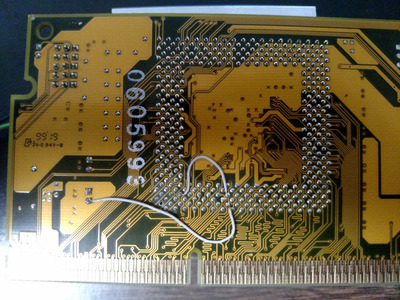

Reply 76 of 91, by Dochartaigh
maxtherabbit wrote on 2020-01-18, 22:42:
just do the mod it's easy
Is that this exact ASUS S370? (NOT the S370-L, or S370-D, or the ASUS ones with the SIX jumpers which seem to go down to 1.75volts? - this one only has 5 jumpers). If so, and that's all it is (1 wire bridging two points, then another wire bridging two other points, I can do that no problem). Just can't be guessing if that pic isn't of the EXACT same adapter - don't want to blow anything up on this computer (already cost me about triple what I wanted to spend 🤣).
**EDIT**, this is mine, it's different than that one pictures by quite a lot. Full-Res pic. I can figure out the short jumper wire of course, and which pin the other longer wire starts at, but would need to know where the end of that wire goes.
dionb wrote on 2020-01-18, 22:44:
Hang on... you say the adapter doesn't work with a Coppermine... both CPUs you have there look very much like Coppermine CPUs 😮
What is the current CPU (that does work) exactly? If it's that other one in the pic, with a blue core on a green module, that's Coppermine too and if that does work, your adapter does do Coppermine! In that case I'd suspect your new CPU more than anything else. What makes you believe the adapter won't do CuMine?
Post the exact S-Spec of these two CPUs. This could be related to CPU stepping if they're both CuMine.
The Slot 1 to 370 adapter came with a 500ish mhz Pentium III (assuming CuMine). That one is 1.65v - and it's absolutely pristine - like the green usually fades a little bit from heat when these are used I think? It's still shiny - I doubt it was ever used and/or tested in this adapter. My 1Ghz P3 Coppermine is 1.75v. I tried BOTH of those in the ASUS S370 adapter and the machine wouldn't boot with either. Put the stock 700mhz Slot 1 (which came stock in this Dell T700r) back in and it boots right up.
If you take a look at the little jumper spec sheet I posted it seems the lowest voltage this adapter can do is 1.80v - above BOTH of those Coppermine's. I don't know if the voltage can drop lower when it's in the "CPU Def." (defined?) default mode where it's supposed to be automatic or what. I tried the jumpers at the stock CPU Def mode, and at 1.80v mode too, on both P3's, and it wouldn't boot either.
Also just reformated the SSD via fdisk (screw 4k alignment for right now - just want to be able to boot into Windows!), and reinstalled windows for the 5th (or is it 6th? 🤣) time, and it STILL boots to the black screen with the blinking cursor on the top left... Original adapter with 2gb SD card still boots up Win 98 just fine...
Reply 77 of 91, by maxtherabbit
1) no it's some random s370 adapter I had lying around that I had to modify for my coppermine setup
2) the longer wire going over to the pin off the socket was specifically for multiprocessing support IIRC, you should be able to skip that one
3) for voltage you should just be able to pick the CPU def. setting and let the slocket pass the VID pins from the socket directly to the slot. Once you do the basic CUmine mods that should boot right up
It's been a while since I messed with slocket stuff so I'm sorry my memory isn't as sharp as it should be to give you precise advice, but the basic mods to convert a mendocino celeron slocket to a cumine compatible one should be well documented on the internet. The hardest part by far is getting the sliding plastic part off of the socket (without fucking it up) to facilitate the pin removal.

Reply 79 of 91, by maxtherabbit
Dochartaigh wrote on 2020-01-19, 00:48:
I'm still googling and reading, but if I can't find the exact mod for this exact board, cross-referencing all these other tutorials to find out exactly what to do to my different board...may just be over my head.
So I bought all this stuff, and this Dell, with the premise that I can upgrade it to around 1GHz (and didn't know the adapter itself has to be modded). Is there other Slot 1 to 370 adapters which will work WITHOUT modding? If so, which ones? And I assume I'll have to wait to find one on eBay?
The modification is essentially board agnostic. Pull the pin, bridge the other two pins, bapzonga.
If you don't want to do it you can:
Buy a cumine compatible slocket (they exist, not that rare but $$)
Buy a Slot 1 Coppermine P3 - price will depend on speed, but the faster 100MHz FSB ones range from rare to vaporware, and are priced accordingly.
