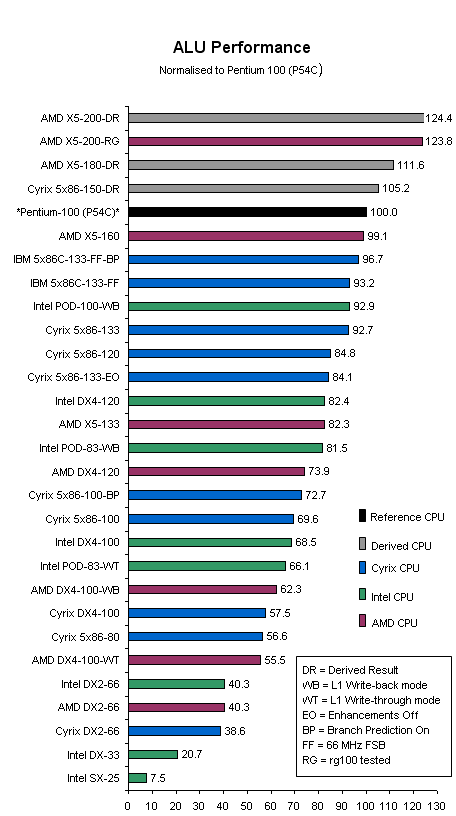

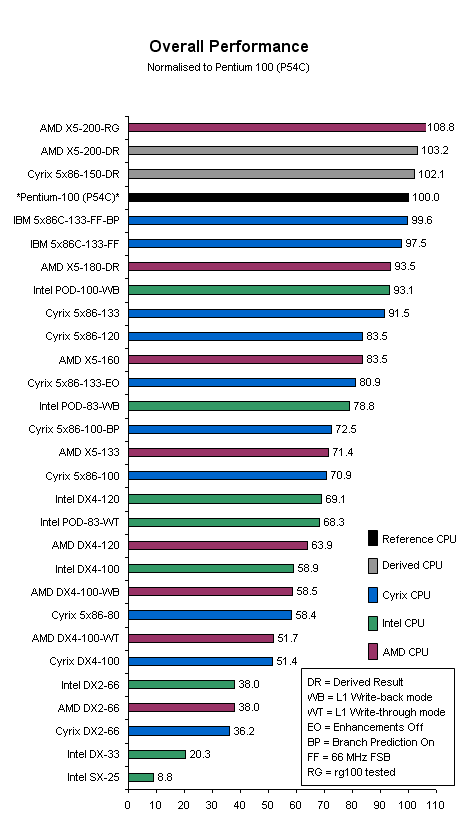

Reply 69 of 101, by appiah4
aitotat wrote on 2022-06-21, 10:16:
It is possible, for example that I forgot it in WT mode when doing 120 MHz bencmarking (I don't remember what order I tested) or messed with some BIOS settings. I can run a few benchmarks again to see if they match. I don't think that is the problem here. It can be seen that Am5x86 is slower than Intel at the same clock and the Am486 does have less cache so it must be even slower.
The first assertion is outright wrong the Am5x86 core is essentially the exact same Am486 core on a smaller node. The second one is true but the magnitude of difference should have been miniscule.
If you don't believe me, again, look here:
The Ultimate 486 Benchmark Comparison
This is AFAIC the holy grail of 486 benchmarks. And feipoa's findings show that there is about 1% ALU+FPU difference between Intel WB and AMD WB CPUs.
Even in pure ALU the AMD part is only 8% slower - and that is due mostly to, yes you guessed it, stupid synthetic benchmarks.
And even then the AMD-120 part is SIGNIFICANTLY faster than Intel-100.
So yeah, something is not right with your test setup. Quite possibly your board runs AMD CPUs with some hidden wait states or something.

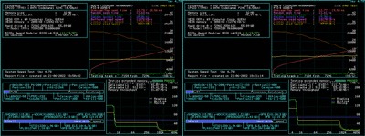

Reply 73 of 101, by aitotat
I redid 100 MHz WB and 120 MHz WB tests for the 8k Am486DX4.
29.68 KiB
1442 views
Here are the new results:
CPU               | 3DBench | PCP VGA | PCP SVGA | Topbench | Quake | Doom min | Doom max
AmDX4-120@100 (8k)| 71.4 | 15.6 | 6.9 | 288 | 10.7 | 664 | 1847
AmDX4-120 (8k) | 83.3 | 18.7 | 8.3 | 334 | 12.9 | 569 | 1553
So no or very little changes. And BIOS and jumper settings are correct. I didn't have sound card installed this time but it should not matter since the tests do not have sound enabled.
I think I'm going to try older BIOS version just in case the last beta from 97 does have some issues with non-Intel CPUs.
Reply 74 of 101, by CoffeeOne
appiah4 wrote on 2022-06-21, 10:30:
The first assertion is outright wrong the Am5x86 core is essentially the exact same Am486 core on a smaller node. The second on […]
Sorry to complain, but I don't understand that figure.
There are AMD DX4 WB, AMD DX4 WT and Intel DX4.
So is the Intel a L1 WT or a L1 WB? I am sure that DOES make a difference.
Or did I miss something?
EDIT: Also according to this figure, the intel 486DX4 is minimum 10% faster than the AMD at same clock. Or when you compare AMD DX4-100 WT with Intel DX4-100 (WB or WT unknown) a lot more.
Haha
Reply 75 of 101, by appiah4
CoffeeOne wrote on 2022-06-21, 18:34:
Sorry to complain, but I don't understand that figure. There are AMD DX4 WB, AMD DX4 WT and Intel DX4. So is the Intel a L1 WT […]
Haha
If you read the thread feipoa points out that the i486DX4 is a WB and the only one he had - he laments not having a WT model.
The noted 8% (not 10%) difference between AMD and Intel's WB models is for ONLY ALU tests and those tests are biased towards Intel due to synthetic benchmarks that unrealistically use 8+ KB L1 cache - you will find that real world applications and FPU tests have no such performance discrepancy and the overall ALU+FPU performance difference between the CPUs is rightly <1%.
Also, paging @feipoa for an expert opinion 🤣

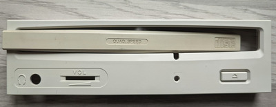

I made my first retrobright attempt. This was just a test to see I don't do anything wrong. Two 3.5" bezels (ivory and grey) and bezel from Mitsumi 4x CD-ROM-drive. Here is how the Mitsumi looks like:
53.34 KiB
1341 views
As can be seen, I did one mistake. I forgot the part from the sled. At least it is now obvious that retrobrite did work. I'm going to retrobrite the original case from this system and take it back to use.
I took a look at old pictures and verified that the original CD-ROM-drive for this system was 4x Panasonic IDE-drive. I should have kept that one. Since I'm now using CF-adapter on front of the case (and a network card once I put this back together), I no longer need those newer DVD-RW-drives to transfer files. So back to good old period correct QUIET CD-ROM-drives. I couldn't find a Panasonic but I did find that 4x Mitsumi I tested retrobright on.
But it was not a good drive. It does not support 80-min CD-R discs at all (it does not detect them). It detects 74-min discs but they must be very high quality discs for it to read them. I also had problems with original discs but recapping helped for that. So basically that Mitsumi doesn't really support CD-R-discs. Even older 2x-speed Panasonic (I like those) does support them nicely. It doesn't support multisession discs (it only sees the first session) but that is not a problem for me. But the 2x-panasonic uses Panasonic interface and that would make sound card stuff harder (I have two or maybe three Panasonic controller cards but there are no free ISA slots).
But no worry. I did find another Mitsumi. It is a 8x drive and supports CD-R discs and is quiet. It is from 96 so a little too new but it will do. I hope I'm going to find one of those 4x Panasonic drives again. No point to change this 8x Mitsumi to anything else.
