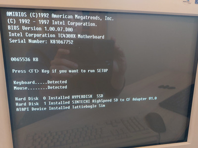

There is a sticker on the board that tells you to set the multipler to 1.5 for 233Mhz.

Reply 66 of 78, by Kahenraz
The sticker is visible on my board at the bottom right. See the photo in the first post of this thread.
Reply 67 of 78, by Jura Tastatura
Kahenraz wrote on 2022-10-30, 12:02:
Is that with the official BIOS?
Yes, I think it's latest official, 1.00.07.DH0
Showing wrong HDD values in BIOS but works like a charm.

Reply 68 of 78, by Jura Tastatura
Other great thing about this board, during BIOS post you can press key combo for turbo switch with "CTRL ALT -" which takes it to "fast 386 DX40" levels that is good enough for playing Wing Commander (and possibly other speed sensitive games). 😀

Reply 72 of 78, by Gmlb256
Kahenraz wrote on 2022-10-29, 01:30:
I managed to fix the overbright issue by flashing another BIOS using shadow ROM with svbl. […]
Luckily, this tool specifically supports the Triton chipset (Intel 430HX). Here is the command I used:
svbl.com /c:triton.cps /b:86C375_5.bin
Neither s3bright.com nor s3black.com worked with this onboard card. I know that these utilities work with other cards, since I have tried them in the past with my S3 Trio 3D/2X.

I found a working BIOS here, and tied 86C375_1.bin, 86C375_2.bin, 86C375_3.bin, 86C375_4.bin, and 86C375_5.bin. 1, 3, and 4 all had the overbright problem. There was some error with 2 that made it fail to load. The only one to produced the correct black levels was 86C375_5.bin.
