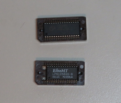

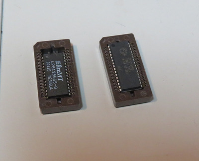

The current revision has one ground pin at the wrong location (and thus not soldered). That's the one close to C6. I will re-run that board with the location of that pin fixed, and the pullup resistor to easily degrade to 512KB added. I need to take a look how much work adding 256KB support would require. Also, routing for the sockets might prove more challenging. Currently, U2/U3/U4, as well as U6/U7/U8 are located at the identical location relative to their DIP socket. This won't be possible with sockets anymore, but I can imagine a layout that could work will with sockets.
Do you have a link at hand for a datasheet of an 8ns 256KB chip? Is it still SOJ32, would those chips require SOJ28 sockets, or can you just plug SOJ28 into SOJ32 sockets?
Yes, the whole PCB layout would have to be altered to accomodate the sockets, but I think people would appreciate this. Perhaps ensure that the socketless PCB works well first.
Unfortunately, I don't have a datasheet for the 32kx8-8ns EliteMT LP61256GS-8. I couldn't locate one upon a quick search. But the pinouts should be the same as CY7C199D-10VXI, for which the datasheet is here: https://www.mouser.ca/datasheet/2/196/Infineo … Dat-3161465.pdf
So far, I've only seen 64kx8 in 8 ns as well. I'm not sure if 128kx8 - 8ns were made. They very well may have been, but I don't have any. Here is a photo of my 64kx8, SOJ32, 300 mil that I have. EliteMT LP61L512AS-8
The attachment SOJ_300mil_socket_64kx8.JPG is no longer available

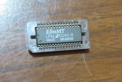

Yes, SOJ28 SRAM modules would fit in the same SOJ32 sockets. I took a photo of EliteMT LP61256GS-8 placed in the same socket as CY7C1009D-10VXI.
The attachment SOJ_300mil_socket_32kx8_and_128kx8_A.JPG is no longer available
The attachment SOJ_300mil_socket_32kx8_and_128kx8_B.JPG is no longer available
mkarcher wrote on 2023-06-09, 17:58:
I might try using a simple round nozzle moving around over the chip edges. I already used that kind of nozzle one successfully to mount the capacitors on the board I show in the previous post. The special nozzle I'm talking about is a knock-off of the Hakko A1184B (original) nozzle.
I don't know your level of experience with hot air and solder paste, but based on the photos you've shown me, I'd probably just use a regular 5 mm round nozzle. It seems to me like you'd only need the parallel lots of hot air if you're soldering on the SOJ modules with pre-tinned pads.
EDIT: I forgot to mention that, luckily, these 32kx8-8ns modules [EliteMT LP61256GS-8] have ample supply from Chinese IC warehouses. The issue I've run into is the ridiculous shipping amounts they want, e.g. $40 USD to just for shipping 10 pieces. Yet when you look for IC's on eBay, they have these $1-2 "SpeedPAK" options. I'm not sure why the IC warehouses/distributors cannot use "SpeedPAK".

Yes, the whole PCB layout would have to be altered to accomodate the [SOJ-32] sockets, but I think people would appreciate this. Perhaps ensure that the socketless PCB works well first.
Exactly. I'm not gonna invest into adaptions of this board until the concept itself is proven.
[quote="feipoa" post_id=1169659 time=1686385460 user_id=22157
Unfortunately, I don't have a datasheet for the 32kx8-8ns EliteMT LP61256GS-8. I couldn't locate one upon a quick search. But the pinouts should be the same as CY7C199D-10VXI, for which the datasheet is here.
[/quote]
OK, that's sufficient. The SOJ pinout seems to be identical to the DIP pinout, both for 28- and 32-pin chips. I'm burned by the fact that the PLCC32 variants of the 27xxx series EEPROMs have two mutually incompatible pinouts: One is used for chips that are also available in DIP28, and the other one is used for chips that are also available in DIP32. The first time I ordered a 32-pin PLCC flash chip, I picked the wrong variant...
Perfect support for 28-pin chips requires a layout change, because they take supply voltage on pin 28 of 28 (aka 30 of 32). While that pin is also at +5V for the 32-pin chips, my current layout exploits the fact that pin 30 of 32 is not highly loaded and thus does not require a low-inductance path to Vcc. I have pin 32 properly decoupled, but pin 30 is connected using a long thin trace which is definitely not following best practice for power trace routing. Or say it more blunt: The way pin 30 of 32 is connected to Vcc is entirely unsuited to be a Vcc pin, especially for high speed ICs. The reason is that I route some address lines between pins 30 and 32, and the trace from pin 32 to pin 30 is routed around the whole bank of chips. The whole address line stuff is routed on the component side of the board because placing vias between the lines of the address bus is quite at the limit of the manufacturing capabilities of the cheap 2-layer process offered by JLCPCB. I'm sure a stable pin 30-of-32 supply can be done, though.
feipoa wrote on 2023-06-10, 08:24:
OK, thanks for confirming. In that case, 256K support is likely possible. I need to make sure to route the address pins in a way that the two pins not used by 32K x 8 chips are actually the highest address lines. Spoiler alert: Currently, that's not the case, because supporting chips smaller than 128k x 8 was no requirement while I did the layout, so I took the freedom to swap address pins as it seemed fit. That's especially interesting for the second bank that has the chips rotated by 180 degrees. I did that because I only connect the data pins on bank 1 to the mainboard, and having bank 2 rotated by 180 degrees places the bank 2 data pins next to the bank 1 data pins. At the same time, I only connect /WE on bank 2, and pull that signal up to bank 1. Only this kind of limiting the pins I connect to the mainboard allowed me to use place the SOJ32 pinouts between the through-hole mounted connecting pins.
