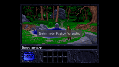

Ant_222 wrote:
Bad news: both the screenshots use nearest-neighbor interpolation and have irregular pixel magnification, which means that the S […]
KainXVIII wrote:
@ant_222, here you go, btw, screenshots from latest ScummVM build (aspect correction on, 1080p)
Bad news: both the screenshots use nearest-neighbor interpolation and have irregular pixel magnification, which means that the ScummVM developers not only have failed to implement pixel-perfect scaling, but also are deceiving their users by calling nearest-neighbor interpolation to the correct aspect ratio "pixel-perfect":
320x200 --[4.0x4.8]--> 1280x960
—only the horizontal scale is integral, whereas the vertical one is a fractional. It makes no sense.
Edit: To clarify—the rows in the "pixel-perfect scaling" screenshot are magnified with alternating scales of 4 and 5 in a ratio of 1 to 4: 4, 5, 5, 5, 5, 4, 5, 5, 5, 5, ... yielding an average vertical scale of 24/5, or 4.8.
Wouldn't pixel-perfect scaling of 320x200 using square pixel flat panels result in wrong aspect ratios? The resolution may be 4:4.8 but it was displayed on a 4:3 monitor.. ScummVM may be doing the right kind of scaling then adjusting it to correct aspect ratio?

Reply 684 of 733, by KainXVIII
Edit: To clarify—the rows in the "pixel-perfect" screenshot are magnified with alternating scales of 4 and 5 in a ratio of 1 to 4: 4, 5, 5, 5, 5, 4, 5, 5, 5, 5, ... yielding an average vertical scale of 24/5, or 4.8.

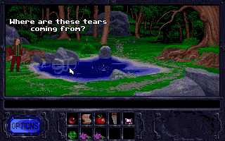

Interesting, still looks good to me (screenshots were taken in opengl graphics mode)
Here is screenshot in Normal (no scaling) graphics mode.
77.38 KiB
2594 views
I need to pick another game though, preferably EGA with heavy dithering where all scaling artifacts can be seen clearly 😎
Reply 685 of 733, by Ant_222
It has some extremely rude glitches in the vertical direction. Just compare it with the original. Look, for example, at the "Options" gemstone in the lower-left corner. Its 45-digree sides are raggedy in your screenshot.

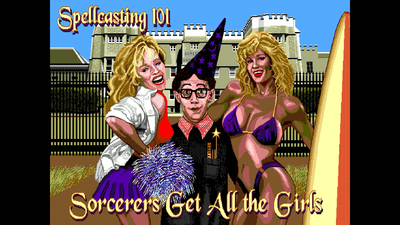

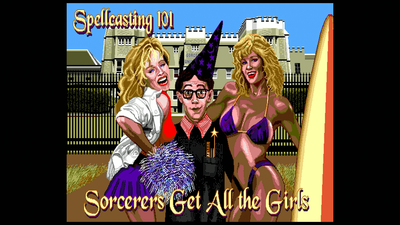

Strange situation about Spellcasting 101 and its EGA resolution(640x350), i somehow prefer openglnb mode aspect ratio despite garbled pixels 😕

Reply 691 of 733, by Ant_222
KainXVIII wrote:
Strange situation about Spellcasting 101 and its EGA resolution (640x350), i somehow prefer openglnb mode aspect ratio despite garbled pixels
The situation is not favourable for the patch: the game's resolution is relatively large(640x350), the pixel aspect ratio (1.37) highly incommensurable, and your display resolution (1920x1080) not very large. The traditional question is—what would you expect the patch to do?
Edit: I was wrong about the high incommensurability of the original PAR. A 1920x1400 display will allow for excellent pixel-perfect scaling:
1.37 ~ 4/3
640x350 --[3x4]--> 1920x1400
