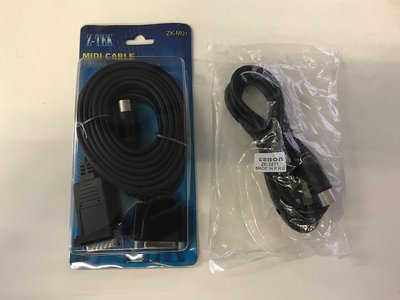

In other and completely unrelated news I will FINALLY get around to testing my card this weekend. 😎

@appiah4
nice, midi cables galore 🤣
