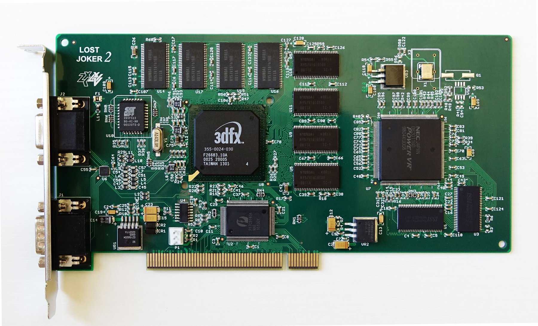

I'm pretty excited. My latest video card has been shipped.
Voodoo 3 + PCX2!
Reply 765 of 1111, by chrismeyer6
That's a fun combo! Where did you find it?

Reply 773 of 1111, by dr.zeissler
5-10 cards? ok we are talking 1000+ USD per card?
Reply 774 of 1111, by mwdmeyer
dr.zeissler wrote on 2021-04-24, 08:53:
The V3+PCX2 was $450. Which I think is very cheap for what it is. I’m not sure if this is the same price for everyone as I purchased the v4 mini-me too.
The V3 section runs at 183MHz. So if you showed me a v3 3500 and pcx2, recapped, for less than 450 I’d be very impressed.

Reply 777 of 1111, by kjliew
I am curious on the technical side of the implementation of such combo card. I wonder if it uses transparent PCI bridge or standard PCI bridge to split the bus, as the later has a software impact that increments the bus enumeration on the new bus segment. Performance wise, both chips now reside on 1-hop bus segment if you use it on legacy PCI chipsets such as Intel 440BX or 2-hop bus segment on more recent chipsets that demote PCI to the south. A lot of Voodoo1/2 era games rely on low-latency, fast access to Voodoo framebuffer. As for the PCX2, if its peer-to-peer PCI bus mastering traffics would be confine within the PCI bridge on the combo card or it relies on upstream PCI bridge for peer-to-peer traffics. The later would further downgrade the performance of PCX2 rendering into Voodoo3 framebuffer.
I wonder if you would really put it into use on retro PC for games or just shelf it for a show. Otherwise, both chips are at least 20 years old of age and the semiconductor process at the time would at most spec'ed for 10 years of physical material degradation.
Reply 778 of 1111, by mwdmeyer
What I find interesting about this card is that the PCX2 can run at 80MHz. So in a lot of tests it is now a bit faster than a Voodoo 1!
The card uses a PI7C 8140 PCI bridge chip. Anthony has explained in more detail but I cannot find the details right now, I will try though.
