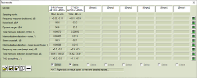

I presume that the SB Live! vs 8-bit SB Pro comparison was hyperbole. That being said, I actually did run some tests on the effects of 44.1KHz to 48KHz resampling on an SB Live! card in the digital domain (no A/D or D/A conversions) using RightMark Audio Analyzer.
I compared it to a modern open source real-time software resampler. The modern resampler is obviously better, but the Live! does not look that bad, IMHO (of course, running udial.wav or a similar corner case through a Live! would be a different story).
Audigy family DSP should be better in that department, because it can do some workarounds with 96kHz resampling.
