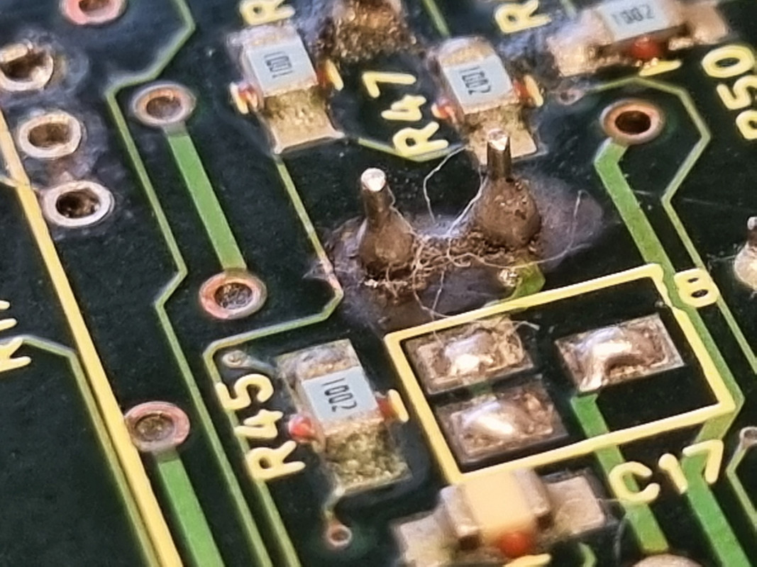

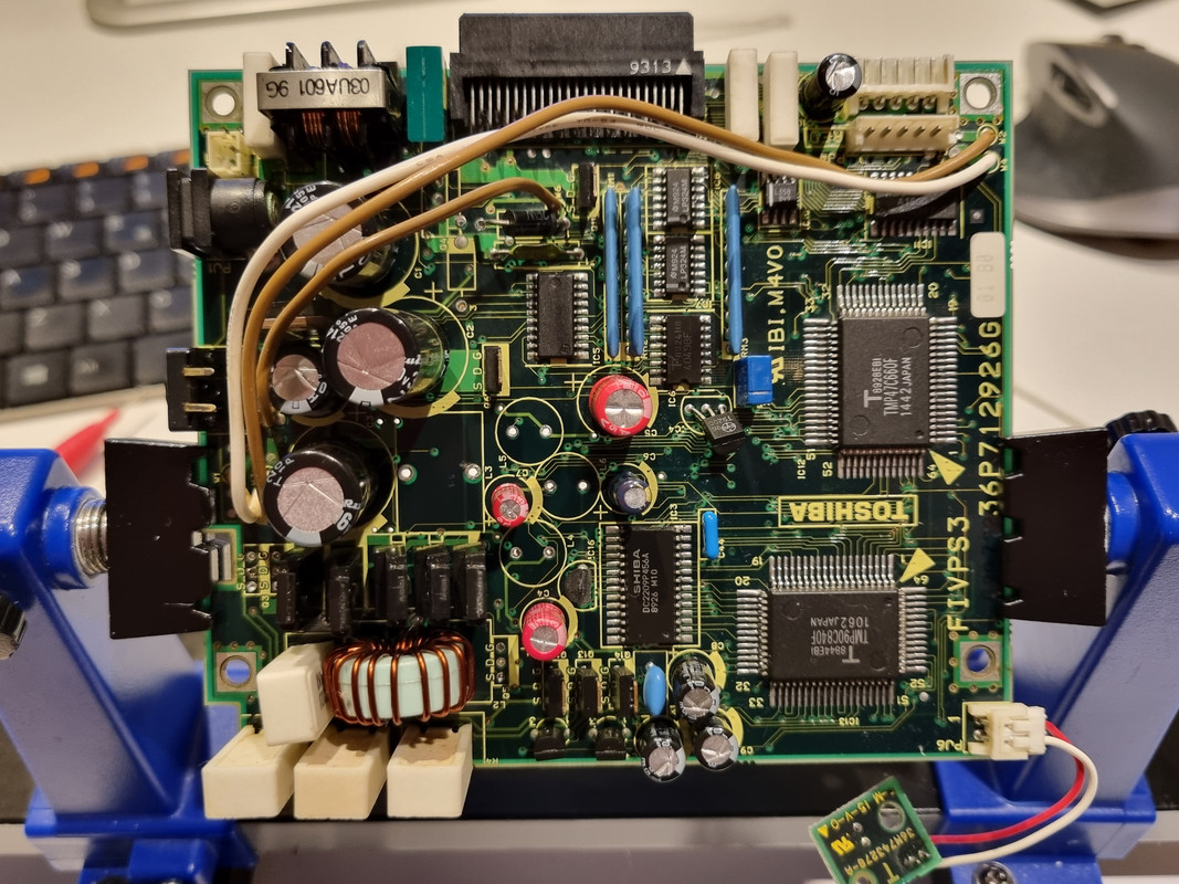

Here some pics from the board and some particular parts:
PSU upside, some components missing...I tried to clean it as much as possible with isopropilic alcool
PSU backside...here I had to change Q29...
C4 after replacement...this was really a mess, C4 and C7 really leaked a lot and corrosion was important, remove them was a pain... The trace on the left seems damage but for the tester is Ok...

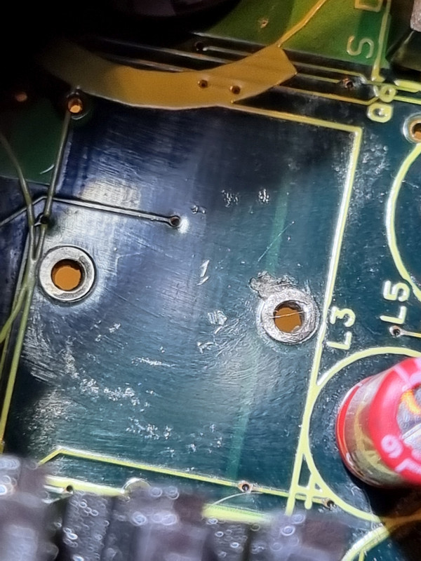

L3 place...here there is something strange on the right hole, I does measure as a short but it does not look so good...again there was some corrosion here...

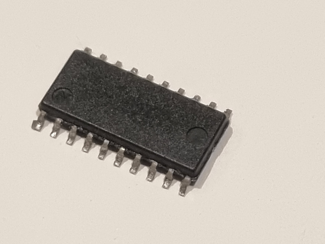

UPA1600 - it lost the tag on it while cleaning...I don't know if due to overheat or what...
Reply 81 of 138, by FuST
That looks like a lot of corrosion on the solder joints.
I'd say the uPA1600's are probably fine (they can take quite some abuse) and the problem is more likely to be a damaged trace somewhere.
First things first though: check if all totempole driver combinations see a PWM signal. You'll need to use single trigger mode on your 'scope for that.
Next check if all the switchmode converters actually switch. I.e. check the output voltages using a 'scope in single trigger mode.
That way you can isolate the problem to a single converter/rail and work from there.
It's all about confirming what does work, crossing it off (I literally cross it off in the schematic) and checking whatever is left in the end. Tedious but doable.

I received the UPA1600 and I substituted it, even if as you are saying most probably it was working. Then I proceed to mount again all components I dissoldered in the meantime (Q19, Q20, Q22, Q23, Diode 8, Diode 12, Q2, Q3, Q4 and Q5)...all these componentes were fine according to my components testers. I checked again all connections to verify continuity and everything was good.

Reply 97 of 138, by Ilcecco
@fust
no luck so far trying to understand this problem. I'm quite running in circles. If i leave the board untouched for a while (even 1-2 days) it can magically start powering up IC13 so with IC2 doing its job. Then it can stop working for no reasons (while still hunting the Q14 issue) and for some time like hours, sometimes a day it refuses to turn back on.
It looks like there is asort of "memory" that is hard to die, like if it has the need to completely discharge one of the capacitors before actually getting fully reset and going back to turn on IC2/Ic13.
I know i'm asking a big favour, but is there any chance i can mail this board to you in order to avoid to lose my mind?
Thanks in advance and in any case.
Stefano
