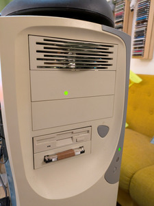

I finished my new 3D printed ATX case today.

Reply 83 of 106, by Major Jackyl
Lynxman wrote on 2025-01-28, 19:45:
Woah, dude. Yes! That looks great! I need to stop being "lazy" (damn work) and make one of those. Did you make it yourself?
That I/O panel looks like it's got some kind of texture, too. What's going on there?

Reply 84 of 106, by Lynxman
douglar wrote on 2025-01-28, 21:10:
How big of a print bed do you need to print it?
392x298 mm. It's very hard to avoid some lifting from the bed even with PLA because of the tension that builds up. GreenTEC Pro Carbon is the best material for it since it doesn't warp and can handle high temperatures while also printing in open printers. I printed this prototype in PLA because it's cheap.
I'm thinking of dividing it up in smaller pieces and releasing it on Cults3D.
The IO is 3D-printed and covered in aluminum tape. My Abit IS7 motherboard didn'tcome with one.
Reply 85 of 106, by Lynxman
The ATX motherboard takes up nearly the full backplate. I wanted the case to be compact. It's an SFX power supply, so it'll probably be expensive to find one that can power that generation that need high power 3,3V and 5V instead of 12V.

Reply 90 of 106, by Lynxman
Size comparison with a typical old school midi tower.
Reply 91 of 106, by douglar
Lynxman wrote on 2025-01-31, 14:05:
How many grams of filament did you use to print that case ?
Did you pre-yellow it on purpose to give it a retro look or was it just a better price on the filament?
Reply 92 of 106, by Lynxman
It uses just about 1 kg of filament. It's painted yellow after printing. I use grey PLA for a lot that wil be painted since it's easy to get good coverage.
