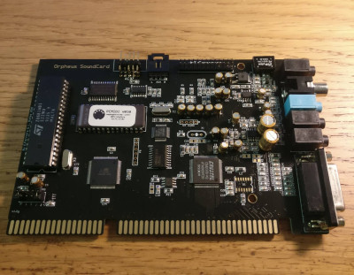

kolderman wrote on 2020-01-03, 20:07:Just needs some chips on it and it will be perfect! 👍
And here it is 😀
Connector colors are not final, we just used blue for telling us what's midi out.
This is basically the last version of board, that doesn't mean that we're stopping here, maybe there will be some tweaks, in some positions of design.
FPaudio is working perfectly.
Todo is only in software now.
1- Disabling Crystal FM in Windows 3.x/9x.
2- Finishing software for activating SPDIF in MSDOS , we can enable it with Debug command and a small script.
Out of interest, was it very common for sound card to have PCSPK inputs? I use that on my AWE32 and it's actually quite useful for lots of pre-1990 games. I guess this Crystal did not have such an input correct?
It has speaker in, we just don't use it. Since PCs usually have internal speakers.
I guess it's too late to request that as a feature...none of my PCs have speakers and it's simply convenient to have the sound come out through the same mixer. Maybe in the next version 😀
PC-speaker input is something I have become quite fond of myself.
SPK_IN was common around the release of first few generations of SB16 but geadually got depreciated as a feature as the PC Speaker itself became more and more useless.
I never use the feature or PC Speaker sound itself personally. If its a game that relies on PC Speaker for sound I will probably play it on my accelerated A500 instead.
Hey Keropi, is it also possible to connect the Cirrus Logic Soundchip to 8Bit ISA only ?
i`m not familar with the Crystal Chipset 😀
^ I think it will work BUT the drivers need 386+ so it kinda defeats the purpose...
To add some detail to the discussion of 8-bit-only use, the CS4237B only has 8 data lines. The part also has a number of ways to go through the configuration without a Plug-and-Play BIOS or configuration manager. This seems to indicate that their design should be usable even on an XT, provided the necessary configuration software is available.
keropi wrote on 2020-01-10, 19:50:^ I think it will work BUT the drivers need 386+ so it kinda defeats the purpose...
Hm the crystal init setup launches on my nec v20, are you sure ?
but it freezes because i have no card inside or other reason.
Maybe i should try it. Anyway it makes no sense to use a CS Chip inside XT.
But it would be interesting to use those 8Bit Slots on 386+ Mainboards 😉
I tried on 286 and it froze too so I assumed the driver is using 386 instructions - which is not surprising considering the original release date of the CS4235/36/37 chips - never really tried it again on another system lower than a 386 tbh
Will check it again on my V20 XT once I get it out of storage
