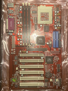

Okay, it’s showtime!
Got off to a scary start. No post…
But eventually traced that back to the gfx and the smi header. Also the computer seems to refuse to post at 100fsb.
I may need a bios update. I think I recall nonsense like this when trying to use k6+ with the bios that was on the other board.
I’ll see if I can dump this bios and discover which bios is on that floppy soon
But good news!! Cpuz works on this board!
I’m gonna be really disappointed if I can’t get this ti500 working on this board. Seller sent a pic of the card posting in another computer. So it SHOULD work…. I just gotta figure out why it isn’t for me…

Okay bios:
The bios loaded onto the board is dated 3/23/2000 according to cpuz
note: was dumped via uniflash, check integrity before flashing
now on to the floppy....
Edit: for no reason what so ever the higher fsb settings are now working. Maybe I had to set bios settings then try again? Idk. But it’s running at 600 mhz now.
And I’ve been unable to recover the file from that disk… 🙁 so sad.. We need to find another source, or maybe send it off for data recovery

Reply 83 of 193, by Chkcpu
Sphere478 wrote on 2022-02-16, 10:15:
Edit: back to the bios, I now believe that the one I dumped may in fact actually be the one we were looking for, the board posts saying D5 and the file says D5 in the name
Yes, your board came with the latest Ultra “D5” BIOS! 😀
I’ve checked your 3/23/2000 BIOS dump and it is a valid BIOS.
Details:
BIOS_ID: 03/23/2000-VP3-686A-2A5LEM2QC-00
Sign-on: FW-5VGF+/ultra-D5-0331
Award version: v4.51PG
This BIOS also supports the K6-2+/ -III+ CPUs and has the “new” 32GB bugfix for HDD support up to 128GiB and to allow drives up to 640GiB to be attached. So nothing for me to "fix"...
Please note that your 3_23_2000 BIOS dump has no file extension so you may want to add .bin to the filename before sending it in for UR. Or rename the BIOS file to “5vgfud5.bin” to match the original. 😉
Jan
