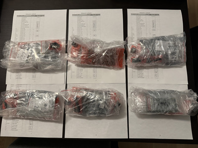

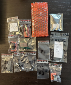

I have received my kit !
After 3 hours of work, here it is almost fully assembled
Now, I tried to order the 86duino and video card from DMP but every time I try, I get a message saying "Pay faile, plase contact us." 🙁
So I tried to contact them but no answer so far ...
One thing I'd suggest if a new revision comes : what about adding a network chip ? The Realtek RTL8019AS chip is readily available as NOS, and network support can always be useful (file transfer, LAN play, etc)

If you can’t order from dmp it might be your bank as there site does not have any validation when using card, like in Sweden I can enable allow payment online for 60min without validation in my bank application for the specific credit card.
That looks awesome, nice soldering! 😀
