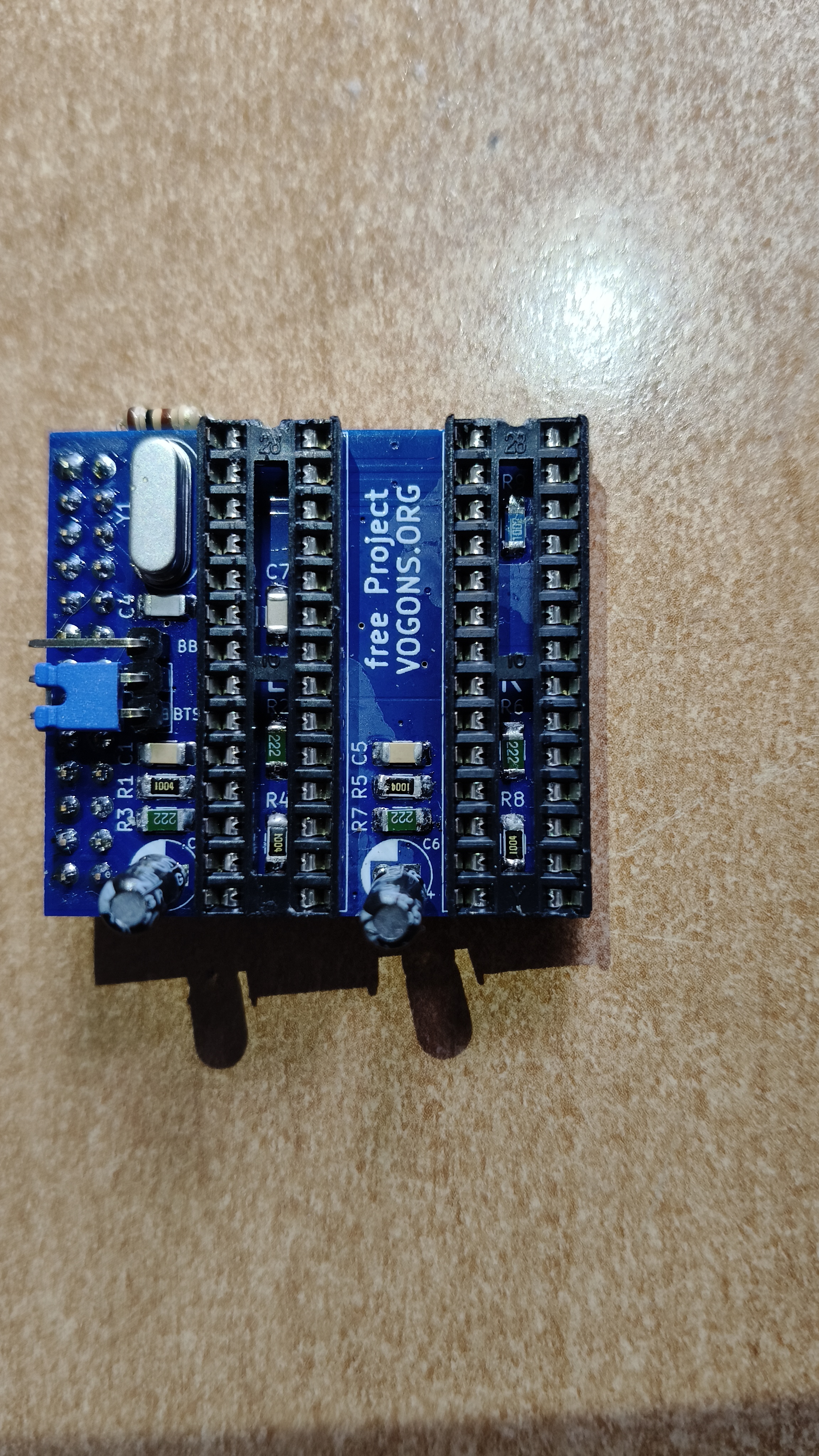

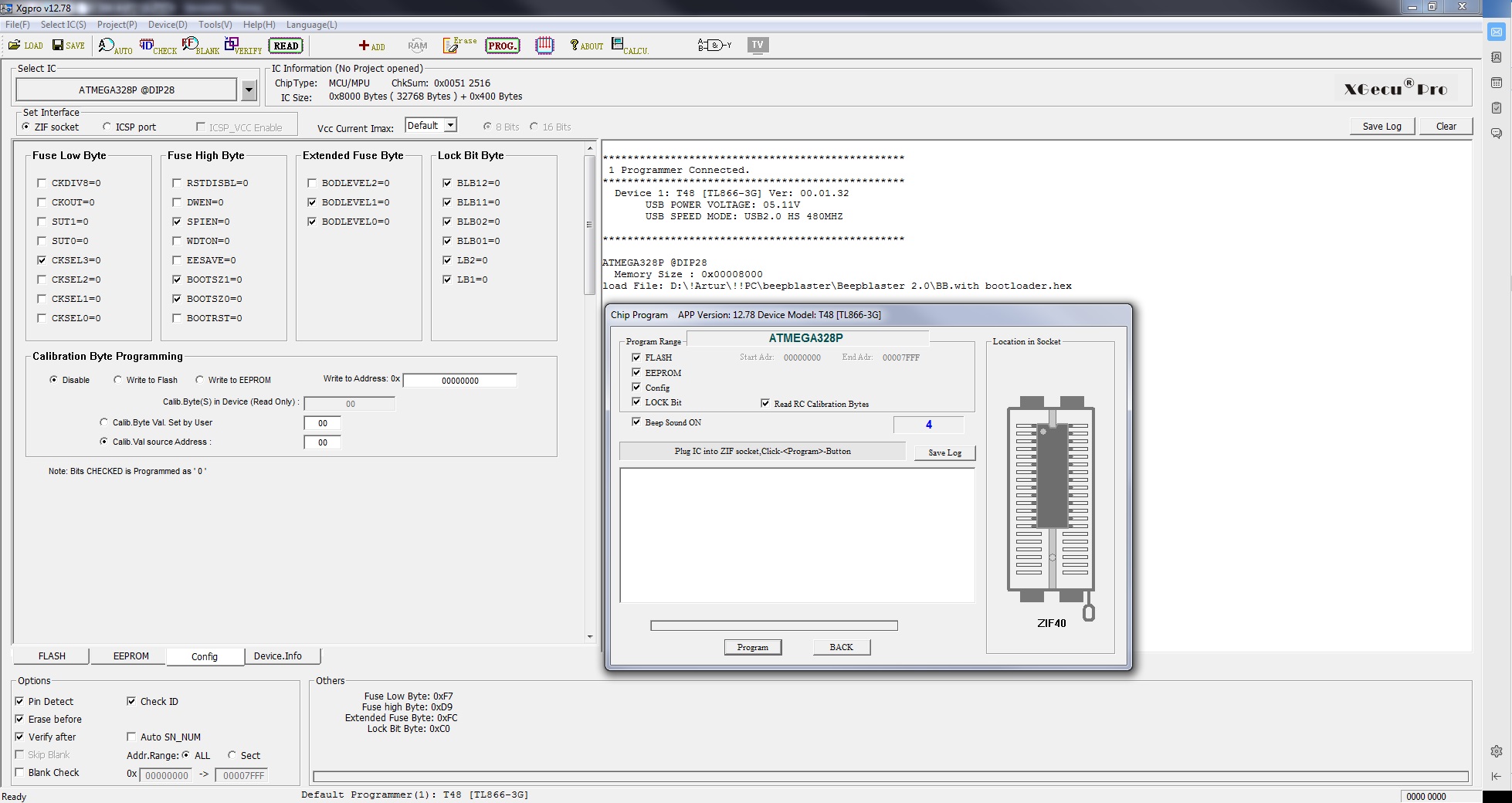

Hello.
I just build Beepblaster 2.0 ant it doesn't work.
After connecting power, instantly all I can hear is high pithed sound, ~7,5kHz.
Looking something like this: "_|_|_|_|_|_|_|_|_|_|_" (sorry i don’t have picture of my cheap oscilloscope ).
On both channels. Swapping chips do not help. Same on only one chip inserted.
I never played with Arduino so I have zero knowledge.
I programmed chips according to added fuses screen (i bought chips completely blank, no bootloader thing).
What I might done wrong?

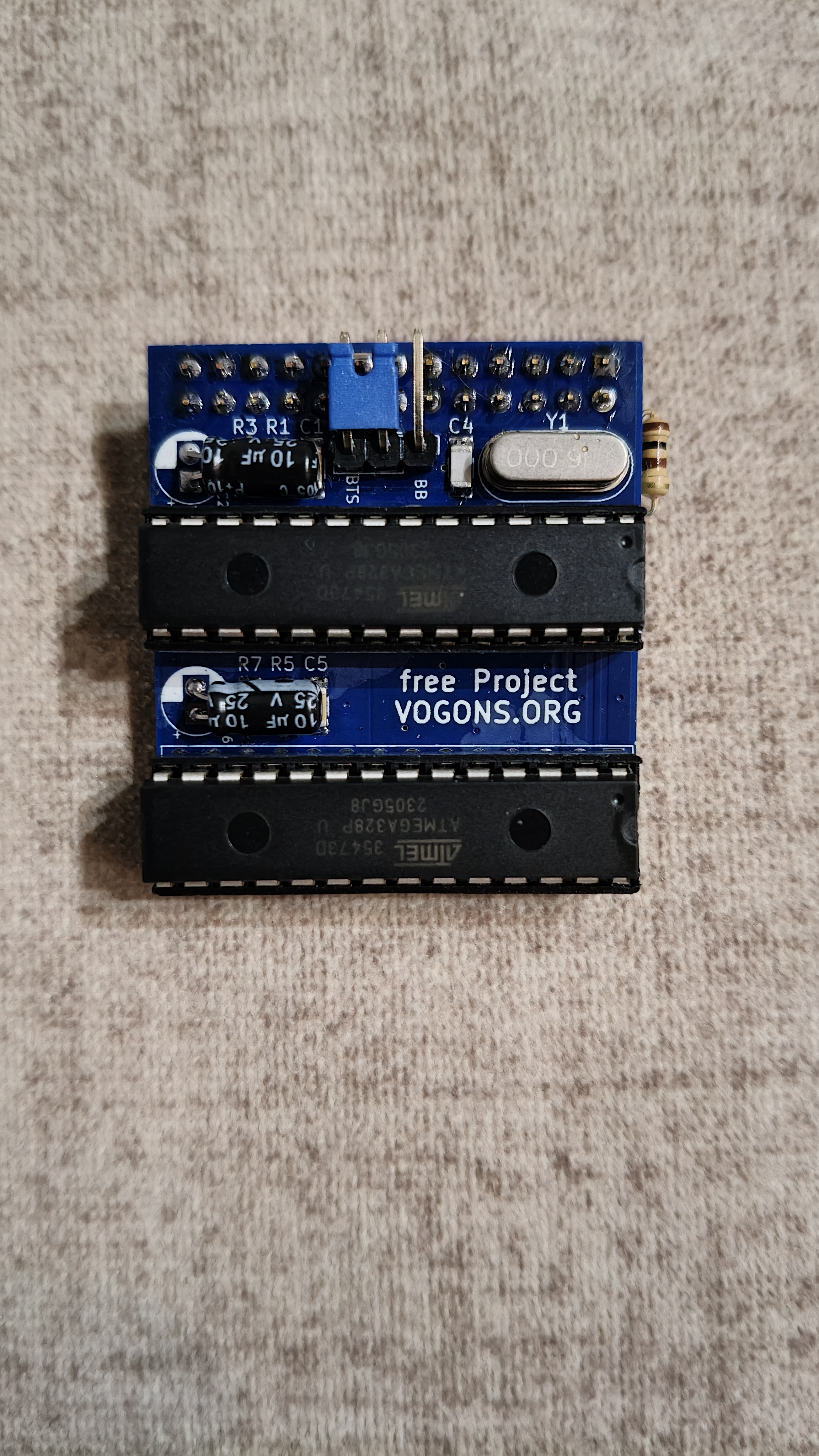

Reply 82 of 86, by MaLLy_R
Ulfenknulfen wrote on 2025-03-12, 11:19:
Hello MaLLy_R […]
Hello MaLLy_R
There are many sources of error for this.
Can you put pictures of your soldering work online?
What device did you use to program the Arduinos?
best regards
Paddy
Many thanks tor reply.
Here are the photos:
TOP http://mally.tim.com.pl/beepblaster/top.jpg
BOTTOM http://mally.tim.com.pl/beepblaster/bottom.jpg

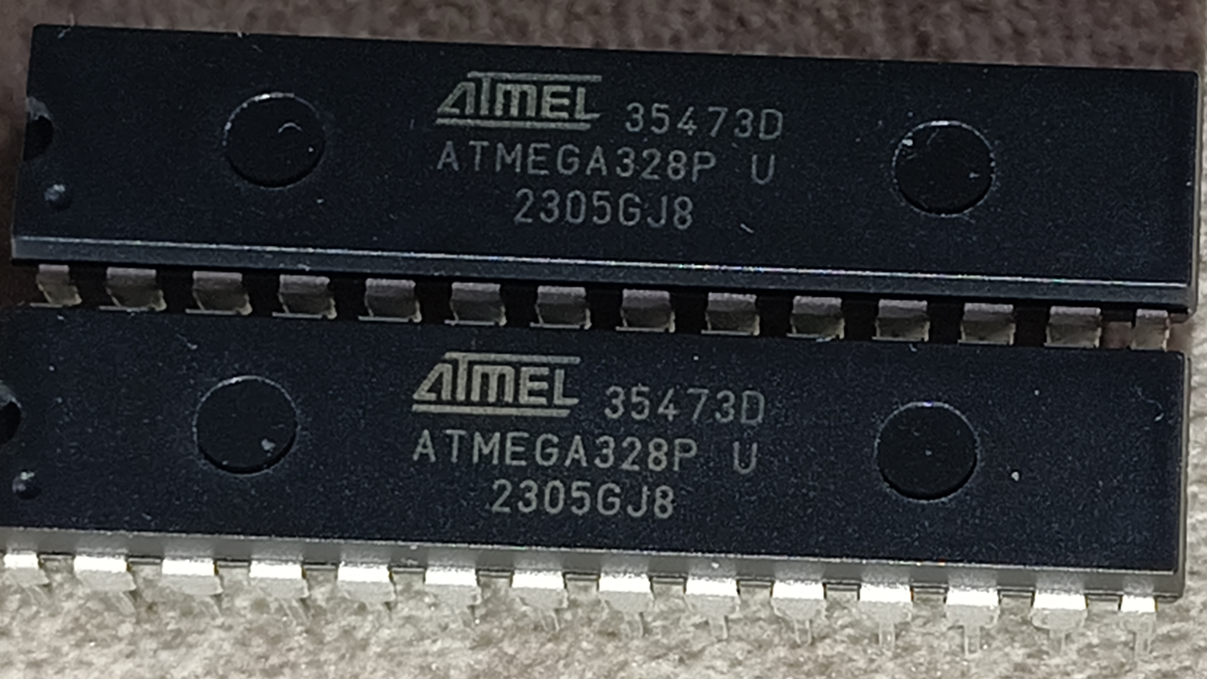

Don't mind THT resistor, i ordered 100K 1206 instead 100R...
TOP WITHOUT IC'S http://mally.tim.com.pl/beepblaster/no_ics.jpg
CHIPS http://mally.tim.com.pl/beepblaster/chips.jpg

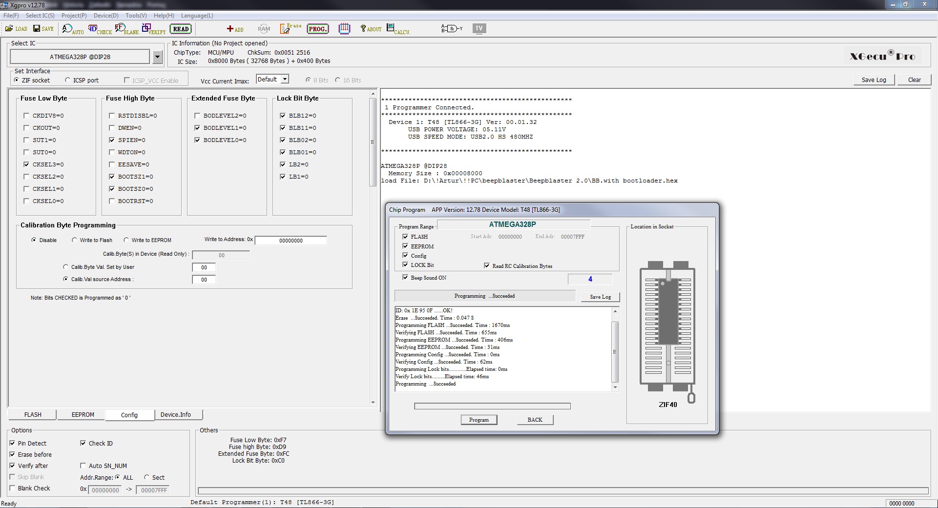

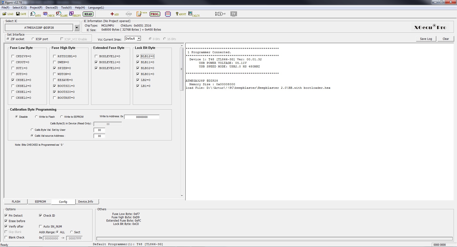

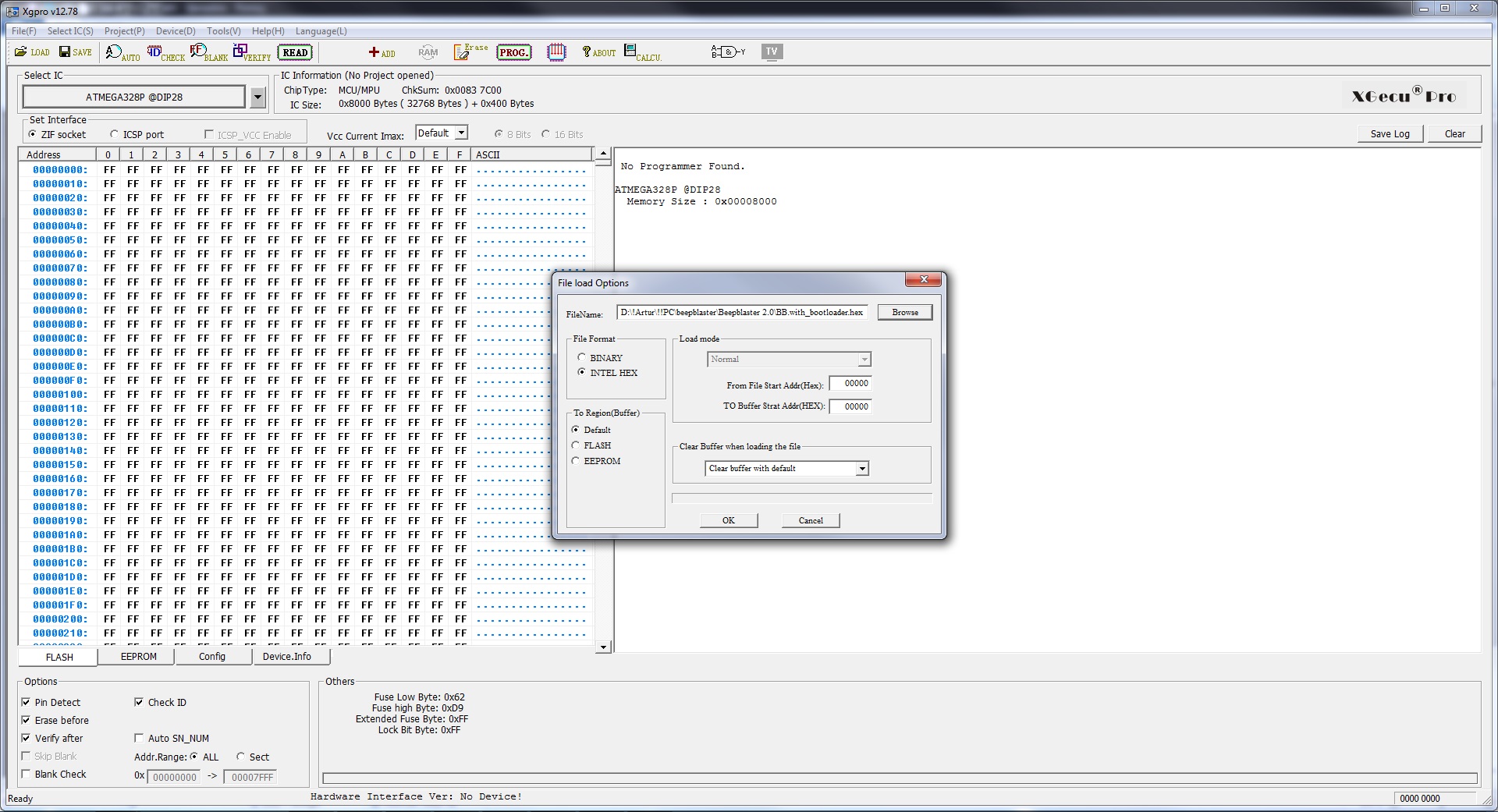

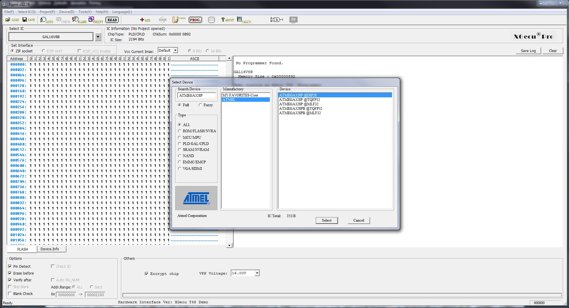

I program them using XGecu T48 (TL388-3G)
Here are step by step pictures how i program them:
1 - http://mally.tim.com.pl/beepblaster/1.jpg
2 - http://mally.tim.com.pl/beepblaster/2.jpg
3 - http://mally.tim.com.pl/beepblaster/3.jpg
4 - http://mally.tim.com.pl/beepblaster/4.jpg
5 - http://mally.tim.com.pl/beepblaster/5.jpg
And little UPDATE:
I programmed them yesterday once more and 7,5KHz tone had vanished.
When there is no midi signal i got silence.
When midi is played i got afoul noise, but it looks like the noise is dependant on what is on midi channel.
Almost like audio out was to loud. (is there voltage divider on out of those chips that i might screw up?)
So it looks like chips are reacting to MIDI.
Maybe something is wrong witch IC'S?
Any suggestions?

Reply 84 of 86, by Ulfenknulfen
Result.
I've checked the device and i've found 2 defective Caps (22pf) - they had just 11 and under 10,
and a defective Crystal.
All 3 Parts are changed, and it's working just fine 😀

Reply 85 of 86, by MaLLy_R
Ulfenknulfen wrote on 2025-03-21, 13:31:
Result. […]
Result.
best regards
Paddy
Dang it.
They are brand new and from two different sellers.
I got scammed... What cost? Measly 2 Euros? Its insane.
It never came to my mind that they could be faulty...
Thank You very much.
