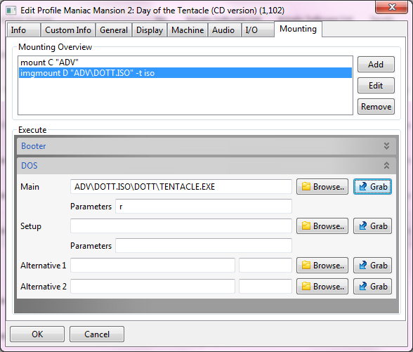

Simply highlight the line which imgmounts the D drive, and press the 'Grab' button next to the main executable field. This copies the mounted ISO filename and pastes it into the field. Then press 'Browse' and you can choose an executable to launch.
It is also possible to first browse to your image file and select that. DBGL will notice it to be an image file, and open the archive browser automatically.
Mind you, FAT image browsing is not available yet, but will come soon.
