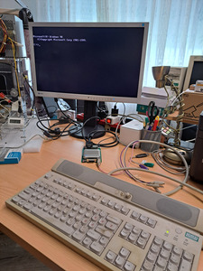

Reply 823 of 1124, by Windows98_guy
I've found the problem. Some of the connectors for the processor module itself were not properly soldered. I didn't notice at all. I guess my soldering iron did not have enough solder on the tip, because I used less solder on it for the sound chip or I just went too fast and it didn't stick well on all of the pins.
Anyway here is the picture of it booting and sd card.
Reply 824 of 1124, by Vridek
Windows98_guy wrote on 2023-06-11, 10:30:
Gratz 😀
