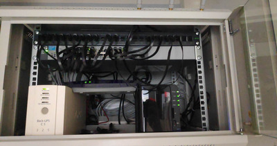

Switched out a switch 😁
Simple dummy one got replaced with a managed HP switch. Let the games begin! 😁

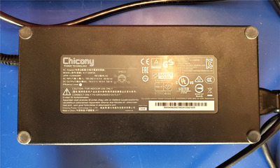

Spent the evening troubleshooting this MSI Trident 3 gaming PC that I use with my media centre. Went to power it up this evening and it promptly shut itself off.
The attachment MSI Trident 3 cover removed.jpg is no longer available
Took it the bench and proceeded to spend a couple hours testing things. On occasion I could get it to boot up to the Windows 11 desktop. I even managed to have it run for about 30 minutes and updated a bunch of Steam games in the process. But then when launching a game, it immediately powered itself off again. System thermals seemed fine with CPU at ~40C and MB at ~35C.
This PC uses an external power brick, a 330W / 19.5V DC supply. Testing with a multimeter and both pins read almost 19.5V on the dot. Power brick barely got warm during testing.
The attachment MSI Trident 3 PSU brick.jpg is no longer available
I suspect the likely culprit is the power brick. There are some generic replacement PSUs from Amazon of questionable quality. The only other viable replacement is a 780W Eurocom power supply that would cost over $700 (CAD) including shipping and taxes.
At this point I'm about ready to give up, but I decide to plug it back into my media centre.
It immediately starts up with no issues. Boots into Windows, able launch a bunch of games, did a bit of performance testing, and even managed to run the Windows 11 updates including reboots with no issues.
I don't get it.
edited:
It seems I spoke to soon. Just tried playing a game for about 20 minutes and it spontaneously shut off again. 😒

BitWrangler wrote on 2024-01-15, 15:17:
Some boards I have had behaving like that have turned out to have a cracked joint somewhere, runs until a lead or contact warms up and expands away, lifting a pad is common. Annoying as hell to find though.
That sounds like it would be a nightmare to try to diagnose. 😮
I found that after the computer shuts off, it won't restart until after I unplug the power brick from the wall. Just unplugging the computer but leaving the power brick connected to mains doesn't solve the issue. It seems like power supply needs to be drained or cooled before it will start working again.
So I strongly suspect a problem is somewhere in the power brick. I'll have to crack it open and try to do some further diagnosis.

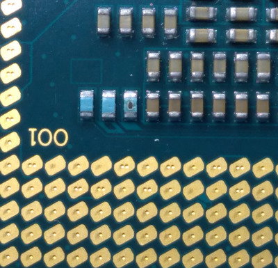

Trying to figure out the value of this burnt smd. My guess is an inductor.
On the bottom of a i3 4170. No power on when installed.
I'll desolder it and test it to see if it works again.

Nexxen wrote on 2024-02-09, 12:27:
If you need it, I have about 40 Xeon CPUs with similar-looking SMDs rotting in a box...
Searching anything Nexgen, PM me if you have one. Also ATI Rage 128 PCI cards.
Good to know, thanks! I'll desolder it and then check the other two. Hopefully they have the same value.
Your bet would be an inductor? I don't have many i3 beyond 2nd gen as I consider those to be "modern" and thus don't really collect them. Probably I should start before they get pricey 😀

That's funny, I see ones like that in that pattern on an i5 3570, but none on either haswell that's handy. Seems like it's an ivybridge thing. I guess you might find one on an ivybridge pentium or celerunt.
Though I'm thinking that it must need to make a connection, or it would still maybe work halfassed when it's burned out, since if it was gonna work halfassed when you desolder it, it would work now. Therefore dunno if you wanna try sticking a 1 kilohm resistor on there instead.... enough connection for connection enough resistance to keep magic smoke in.

Minutemanqvs wrote on 2024-02-09, 20:29:
Thanks!
I desoldered the component and cpu still dead. No codes.
While trying an i5 two caps came off, one I found the other no clue. Still works though.
It's death trying to resolder it.
Edit: it measured 850nF 0.5 ohm, 5.8% ESR
