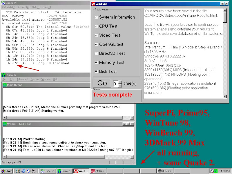

I am really interested in this thread. I have set up an Asus P2B rev 1.12 mobo. It uses the i440BX chipset. I have set the bus speed to 133 MHz speed. I am using a 1.4GHz 133FSB Tualatin server chip, in a PowerLeap adapter (revision 2). I've got 2 sticks of 128MB CL2 SDRAM (total 256MB) in it, and I'm using a Voodoo3 2000 AGP VGA. I decided to run these tests in this order
1) I ran SuperPi, and selected the longest test available which was 32M. I ran this test, and let it continue in the background...
2) While SuperPi was running, I ran Prime95 and selected the default test which is called "Blend". I ran this test, and let it continue in the background...
3) While both SuperPi and Prime95 were running, I ran WinTune 98, and set it to run its tests 9 times. I unchecked the Direct 3D test option, because it complains about not finding a Direct 3D device.
4) After WinTune 98 had finished running its 9 tests, I ran WinBench 99. (I did not close WinTune 98.) I selected "custom tests", and choose all of the graphics tests. There were 47 of them.
5) After the 47 WinBench 99 tests had finished, I ran Quake2 (I did not close WinBench 99), and ran the Quake2 demo called timedemo demo1.dm2. I let it run for about 7 minutes. It ran it in 3dfx OpenGL mode, with a resolution of 1024x768. Afterwards, I quit Quake2.
6) I then ran 3DMark 99 Max's default benchmark test twice. Afterwards, I did not close 3DMark 99 Max.
7) I then repeated all tests from 3) to 6) inclusive.
Test start time = 13:39 PM
Test end time = 15:24 PM
Total running time = about 1 hour and 45 minutes.
The overall result: no crashes, no lock ups, and no strange stuff. I remember testing an AOpen AX6BC, and finding it curiously unstable. I think my tests were set to 133 MHz on that board. I do remember getting lock ups. Gerwin, I think the problem is not i440BX + 89MHz AGP = problem, but AOpen AX6BC + 89MHz AGP = problem. I think you need to test a different mobo. The Asus P2Bs are about the best you can get. You even get 3 ISA slots! 😀 I've tested this thing @ 150 FSB, and never had a lock up. I might run those 1-7 tests again, at 150 FSB. Time permitting...

I set the P2B mobo's FSB to 150, which means the AGP is running at 150*2/3= 100 MHz. When the desktop appeared, the system appeared to have locked up. I wasted no time in testing this situation any further, and so I uninstalled the V3 card. In its place, I installed a GF3 Ti200. That works! I ran through all of the tests numbered 1-7 again. No problems! I decided not to run all of these tests twice, because I didn't want to spend that much time on this.
One thing about these new tests that was interesting - I set the Powerleap's voltage from 1.45 (default for the Tualatin) to 1.65. I did this because the 1.4GHz CPU needed a boost, as it was running at 150 FSB, as opposed to 133. Usually, 1.6 volts is OK for this kind of boost, but I was lazy and the jumper setting for 1.65 was easier to set. However, after 22 minutes of testing, I noticed that Prime95 had failed. So I increased the voltage from 1.65 to 1.7, and that fixed the problem. I reran all of the tests 1 to 7 again, and no problems occured.
