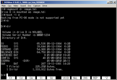

Reply 1285 of 2397, by TheGreatCodeholio
DOSBox-X emulates IBM PC/AT mode by default.
To get PC-98 mode, you will need:
[dosbox]
machine=pc98
Then
imgmount d: image.hdi
Which will attach the contents of the HDI image to drive D:
HDI images have a header that describes the geometry, so the -size option is not needed.
DOSBox-X project: more emulation better accuracy.
DOSLIB and DOSLIB2: Learn how to tinker and hack hardware and software from DOS.

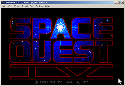

Reply 1286 of 2397, by AnnaWu
Thanks a lot for the help. Just see the booting from PC-98 mode is not supported yet.

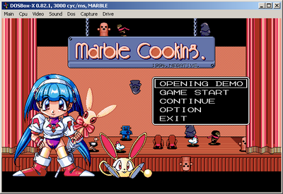

Reply 1289 of 2397, by AnnaWu
Wonderful, today is my first time to hear the nice FM 86-board sound on DOSBox-X in PC98 mode.
I edit the startup lines.
[autoexec]
# Lines in this section will be run at startup.
# You can put your MOUNT lines here.
imgmount d: "c:\Emulator\PC DOS\DOSBox-X\Software\Hard Disk\Marble_Cooking.hdi"
d:
autoexec.bat
Thanks again, TheGreatCodeholio 😊
