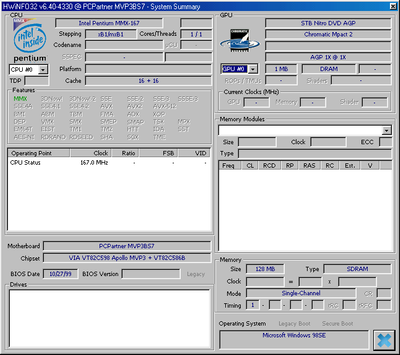

Reply 40 of 42, by Takedasun
STB Nitro DVD 4MB AGP (Chromatic Mpact 2).
Pentium 166MMX
The attachment HWiNFO32.png is no longer available

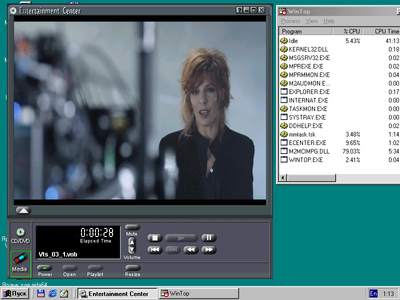

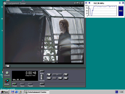

Playing DVD video.
The attachment DVD_play_STB_Nitro_DVD_01.png is no longer available
The attachment DVD_play_STB_Nitro_DVD_02.png is no longer available
Smooth video playback with a good frame rate.
