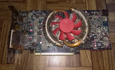

I will probably have a post about another mystery card, though this is pretty obviously a 2005-2010 or so PCIE card, and I know the brand, but the numbers on it simply don't resolve when I search for it. Need to clean the miserable dirt off it and get pictures. It may not work, it was smashed pretty good, part of the heatpipe cooler was bent down and interfered with the fan. On the other hand the percentage of "junk" I receive that doesn't work is shockingly low, I mean like 5% low.
Edit: I think it's a Radeon 6850, I've polished the PCIE connector a little, cleaned the dirt and cobwebs off, there's a lot of corrosion on the board and the connectors, I bent half of the cooler back up so it's not mashed into the RAM and it clears the fan, but it's corroded as well. Of course, it works fine. I'm starting to think that fragile electronics are a myth. The fan even turns quietly, though I think it's running a little slow:

Looks like a HIS Radeon 6850 with the plastic shroud removed. Pictures here seem to match it pretty much perfectly, aside for perhaps the PCB's shade of blue: https://www.hardware.fr/articles/821-7/his-hd-6850.html

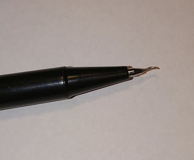

It's not exactly retro, but I got a stack of motherboards in the 115x range with bent pins because they were handled improperly. I do have an endoscope I can attach to a tablet I have, and a way to hold the scope and light, but my current tools for manipulating pins are not quite down to things that small.
My tool of choice for fixing broken LGA sockets is a simple home made one, made from a 0.5mm mechanical pencil and a regular sewing pin with its head snipped off:
73.3 KiB
1048 views
If you want the pin hooked like in the picture, you'll have to heat it up to an orange glow first. Those things are hardened, and will just break if you try to bend them without softening them. After bending it, you can reharden it by heating it up again, and then cooling it quickly, if you want. I didn't bother though, and that's probably why the pin looks like it looks, it's seen a lot of different uses through the years 😀
