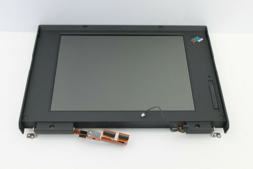

I am looking for a Display ribbon or entire display assembly for an IBM Thinkpad 755.
The ribbon is wind up in a coil and unwinds when you open the lid.
IBM solution for a laptop display.
The problem is that in time the ribbon coil rubs on the thinkpad housing and on itself and ends up getting damaged.
So now the thinkpad has distortion in the display.
at first I thought it was just the display so i was able to find a NEW display on ebay.
But the problem was actually the display ribbon.
I think the replacement part actually comes with the ribbon.
But I do not have a ribbon and could not find one for sale on ebay.

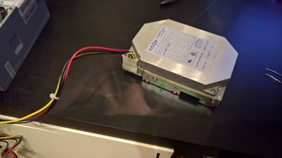

You know your Kalok HDD is a girl, when you power it on and starts blowing a lot of pink smoke!

Logic board might've failed. I had hard drives that had black smoke come out when I would flip the switch on the power supply.

Just one of tantalum caps. Drive wouldn't start, activating overcurrent protection in the PSU as well. Then flames and smoke started coming from under the drive. Those caps usually just pop like fire crackers - this time it was different. Now the drive spins up OK. I will just replace the caps on the board and see what happens.
Reply 11758 of 27441, by bjwil1991
Ah. MFM hard drive, right?
