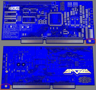

Back & front side of Prototype 1:
(Eagle3D introduces some bugs, like missing out the component names, rendering cut out polygons differently, some silkscreen nonsense)
Current Project: new GUS PnP compatible soundcard

Reply 667 of 3174, by j^aws
421.02 KiB
1842 views
This looks great, but I'd like to make a suggestion if it isn't too late: See those red circles I highlighted on ARGUS, can that 'overhang' be removed along the red dotted line on the PCB?
The reason I mention this is that on some motherboards, when an ISA card is seated, this kind of overhang physically interferes with nearby socketed ICs that are quite high - meaning this overhang could touch an IC on the motherboard and prevent ARGUS from seating properly within the ISA slot.
I've had to remove this type of overhang using a file to fix this issue with some motherboards. It would be a shame if I needed to do this with ARGUS.

Reply 669 of 3174, by shock__
hard1k wrote:
I understand that it might be too late but just can't but suggest something. What if we remove the jumper description completely, put a larger ARGUS demoscene-style logo in that place, and the classic GUS-style logo goes on the back of the card - and as it is on the silkscreen layer, it can be made muuuuch bigger - like that Intense3D logo occupying almost the whole surface of the corresponding Voodoo Rush cards.
Just keep in mind that in current design it will not be seen due to the SIMM hanging over it, and the demoscene-styled logo won't be seen in many configurations due to being on the back.
Just for your consideration 😀
To be perfectly honest - no.
I like the jumper descriptions and adding silkscreen to the bottom would increase the PCB price by another 30%. Also large areas filled with silkscreen overlapping with vias/drills looks ugly - kinda like some kind of acne on a PCB 😁
Once the SIMM is installed people will barely throw looks onto the card anyways 😉
About removing the overhang near the ISA connector, that issue was discussed a few pages back. There are various reasons why I'm keeping it that way:
a) It's the mainboard being in violation, not the card as it's perfectly within ISA specs - also you barely see that overhang lacking completely on commercially made cards.
b) I can creep it back so it goes in line with the lower edge of the silkscreen of the joystick port - that way it might still fit if there's a small SMD IC in the way.
c) Your suggestion causes the joystick mount to be left hanging in the breeze, while the mounts still could interfere with whatever a mainboard designer not paying attention/being lazy put there.
There's one major design issue tho ... the acronym/backcronym is written out nowhere on the card. Actually found that quite funny when it became known to me earlier.

Reply 670 of 3174, by j^aws
This would be a good compromise, as it shaves off a few millimetres. In most cases with motherboards having this issue, that's about what I needed to file off. If I need more, and I really want to use a particular motherboard, I could file into the joystick port as a last resort!
Reply 671 of 3174, by shock__
j^aws wrote:
2.54mm to be precise 😀 Also if you check _NONE_ of the Gravis made cards does that.

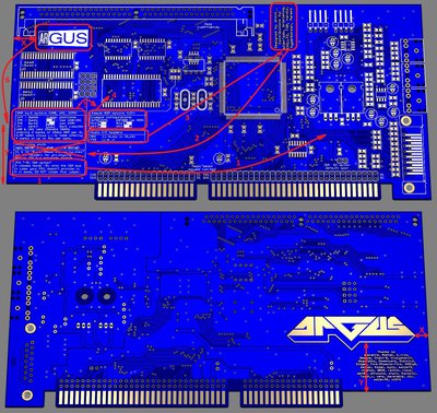

Although the design issues will be covered when it's time for a production run, I've had some free time and tried to formulate my suggestions in more understandable way illustrated by the attached madskillz 😀 Please take it as some ideas for additional consideration as I don't want to seem a little bit too much insistent - just want the project to happen as perfect as it can both in its consumer features and appearance 😀
So, here we go...
1. Split the "Prototyping stuff" section, delete the ISA-header part and move -5V jumper description closer to the jumper itself.
2. Move the "Designed by 2015 by shock__" and "Contributions by..." section to the place where "Prototyping stuff" section used to be, aligning it with the the "Thanks to" section on the back side in terms of horizontal and vertical offset from the edges of the PCB.
3. Move the "Audio I/O headers" section to the place where "Designed..." section used to be.
4. Put "Sample ROM options" right under the footprint of the ROM itself - as there will be no DIP socket and the ROM will by all means be soldered, there is no use in describing the alternative resistor options when the chip is already there. If someone solders it out and finds a description, it'll be a good surprise for him 😀
5. Move the "RAM banks options" section to the place where the "Sample ROM options" and "Audio I/O headers" used to be.
6. Move the ARGUS logo on the front side to the place where the "RAM bank options" section used to be, aligning it with the other logo on the back side in terms of horizontal and vertical offset (marked X and Y on the scheme) from the edges of the PCB as well as bringing them to some similar size (if possible, of course - but it will look much more professional, I guess).
7. Make the ARGUS logo on the front side in copper instead of silkscreen like the other one on the back side. I don't know if we can also play with the silkscreen, I mean, for example, put the frame and the filling of the right section in white silkscreen and the letters in copper. What do others think?
8. Add year 2015 somewhere, e.g. "Designed in 2015 by shock__", possibly followed by "... to commemorate the XX Anniversary of InterWave" as the space that has been freed up allows to do so.
9. Another point - does your plant provides for any silkscreen colors other than white? If yes, then I'd definitely suggest using yellow for all silkscreen inscriptions - just look how cool it is on the Roland SCB-55 and VideoLogic video cards!
    776.01 KiB
    1690 views
    Illustration for the described points
