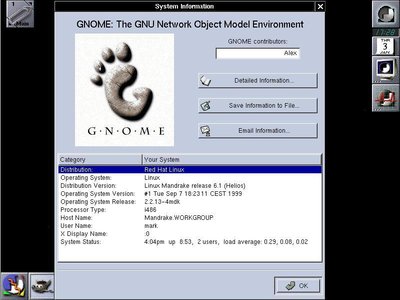

Retromania your first post images seem to be broken. You can save images direct to your vogons.org post. CDSs are small but quite weighty. You don't want to move them around often. Here's mine whilst I was install wfw 3.11 while surfing the net on my Zenith 286/12:
23.22 KiB
1496 views
FWIW I ran Mandrake 6.x on mine for quite a while which supported all it's hardware without hunting for drivers.

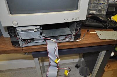

BTW when you changed the hd and the cdrom on yours, you had to remove the entire plastic case? or its possible to do it only by pulling the board out from behind?
www.retromania.pt
Reply 33 of 93, by Caluser2000
Undo the two screws at the bottem of the bottem drive/speaker front cover. Make sure they are complelely removed. Then the front cover can be taken off. It clips in quite tighly so be patent. It slides out from under the monitor bezel. Once it's removed you will see two screws holding the hdd/crom drive cage. Undo these and the cage will slide out.

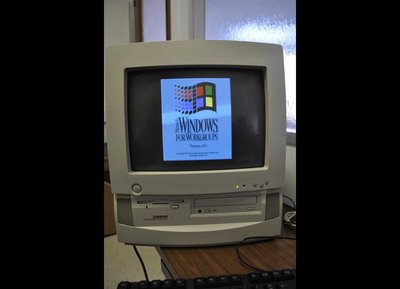

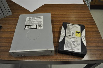

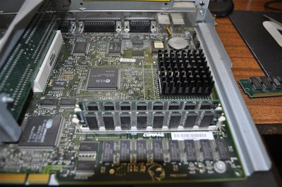

well thanks to a great friend of mine, the upgrade has begun 😁

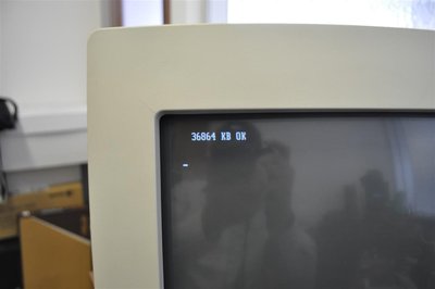

UPGRADE:
- 32mb ram + 4mb onboard = 36mb (original 8mb)
- cdrom 48x (original cdrom 2x)
- HD 4,4g (original 468mb)
- windows 3.11 / msdos 6.22

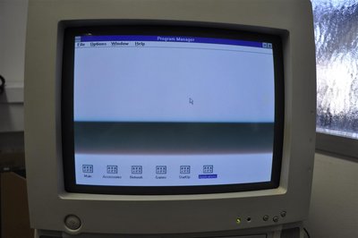

PHOTOS:
178.39 KiB
1411 views
BOARD WITH 2 X 16MB RAM ADDED
83.38 KiB
1411 views
NEW RAM DETECTED + 4MB RAM ONBOARD
121 KiB
1411 views
FRONT PANEL OPENED TO ACESS CDROM / HD
135.6 KiB
1411 views
139.01 KiB
1410 views
ORIGINAL HD / CDROM REMOVED
www.retromania.pt

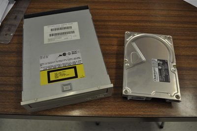

Reply 36 of 93, by Retromania
142.59 KiB
1410 views
CDROM 48X / HD 4,4G [REPLACEMENTS]
55.18 KiB
1410 views
COMPUTER ASSEMBLED WITH NEW CDROM / HD
108.66 KiB
1410 views
WINDOWS 3.11 FOR WORKGROUPS
