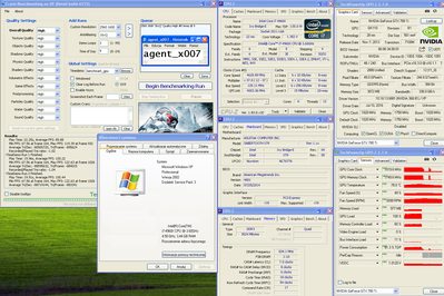

Ask and you shall receive (4960X OC'ed + GTX 780 Ti [Reference with Skyn3t mod vBIOS]) 😀
Crysis @ 2560x1600 + 16xQ AA (that's native 16x MSAA) :
533.75 KiB
6321 views
1) I can't use DSR or Downsampling with WinXP (I didn't install GeForce Experience, just FYI - it didn't do anything).
2) I tested Crysis stock with 4k Downsampling*, and 3GB VRAM is good enough for 4k @ MSAA 8x (without "Q").
*On Windows 7 (since XP doesn't do DSR/Downsampling).
Reply 97 of 241, by Ozzuneoj
agent_x007 wrote:
Ask and you shall receive (4960X OC'ed + GTX 780 Ti [Reference with Skyn3t mod vBIOS]) :) […]
2) I tested Crysis stock with 4k Downsampling, and 3GB VRAM is good enough for 4k @ MSAA 8x (without "Q").
Awesome! If Crysis can run at 67fps minimum and 100fps average, then presumably any less intensive games that are natively DX9 should run at least as fast.
You should run something really old, like the earliest 3D accelerated Windows games that work in XP. 🤣

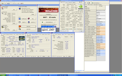

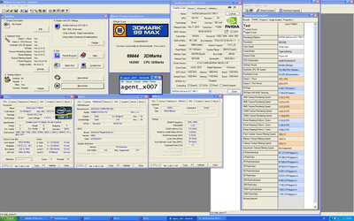

Reply 98 of 241, by agent_x007
I did run 3DMark 99 Max and few more 😉
226.17 KiB
6316 views
232.69 KiB
6316 views
