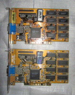

Reply 25 of 32, by The Serpent Rider
Apparently this fix does not fully work on some cards. I have two practically identical ASUS cards, one is Trio64V2/DX and the other is Virge DX. Patch works fine with Trio64, but Virge DX does not show any additional VESA modes, performance is increased though.
1.15 MiB
2335 views
Switched to BIOS chip from a common Virge DX card and the problem disappeared. It seems some vendor altered BIOS might cause problems.

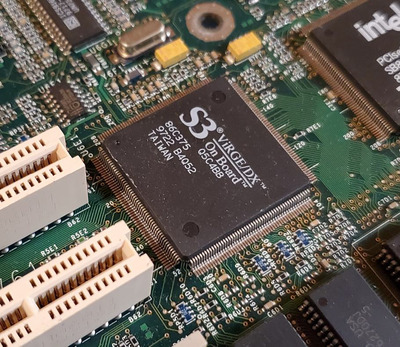

Following up on this. It does not fix the overbright problem with the S3 ViRGE intergrated into my Intel 430HX motherboard. It also seems to be immune to other methods of fixing it, which work on other cards that are not integrated. I managed to find a compatible BIOS that could be flashed to shadow ROM, which may help to provide some insight on why previously known working methods don't need to have an effect.
Re: Intel TC430HX Socket 7 motherboard repair
161.34 KiB
1377 views
