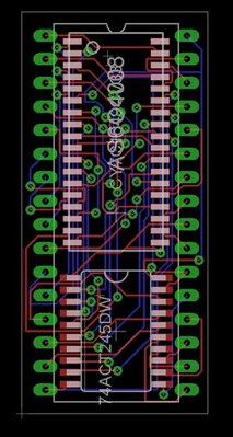

I also designed a breakout board to adapt 36-pin J-lead SMD memory (AS7C4096, CY7C1049, etc) to the AS6C4008 footprint. I'm not sure whether I'll bother trying this, but the breakout board was pretty easy to design and cheap to make. These are 10ns RAM chips, for what it's worth.
What would it take to include a buffer on that breakout board? James Pearce's card has a buffer, the schematic is here:
https://www.lo-tech.co.uk/w/images/a/a2/Lo-te … hematic-r02.png
I feel like each breakout board would require it's own 74ACT245 but otherwise use the signalling that's already available on the socket.

Reply 317 of 613, by smbaker
I made the buffer fit:
48.59 KiB
788 views
I did have to violate the design rules for osh park to make it happen though (calls for 15mil board edge-to-trace clearance; I reduced it to 10mil, which will probably work). I'll sanity check this some more tonight and then see about getting some prototypes made.
Reply 318 of 613, by keenerb
If you order a couple I'll reimburse you for two, if you want to make a big batch.
Assuming you're U.S. based, anyway. Obviously they are untested and possibly (likely?) not going to work, but the more the merrier when it comes to troubleshooting.
