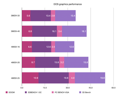

Hope you don't mind me reviving this thread.
I finally got myself to comparing the 486SX-16 against 386DX-40 (where everything else is equal). Something I wanted to settle for a very long time (at least since 1992 when I started wondering about the same 😀.
The results are not particularly surprising. It turns out the486SX-20 is roughly equivalent to 386DX 40 and the 486SX-16 is more or less equal to 386DX-33.
145.92 KiB
571 views
A short write up and more details are here.
Any comments are welcome.

Very Nice!!! It's cool that the 486SX16 lines up so close to the 386-33 and the 486SX20 lines up so close to the 386-40. That lends itself to an easy to remember 2:1 ratio for comparing 386's and 486's clock speeds.
What video card and storage did you use?
Can you do a comparison of ISA vs VLB from 386 to faster 486s? I was always curious to see evidence of a clear MHz inflection point where VLB really starts to become important rather than the 486-66dx2 rule of thumb.
Anyway you can quantify the % performance change for both the 386 & 486 chips from the OPTi 496XLC chipset compared against better performing chipsets?

mpe wrote on 2021-03-08, 14:03:
...and the 486SX-16 is more or less equal to 486SX-16.
Just imagine a world where it isn't ... 😉
