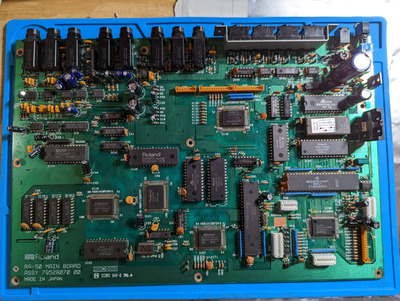

Mod worked great! Very happy with the outcome. One question I had was I saw in some of the images it looked like most boards had a socketed CM-32L ROM in the center of the board. In mine I had a soldered chip, not sure if it is any different? Picture attached.

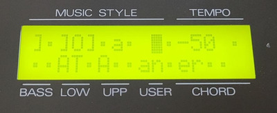

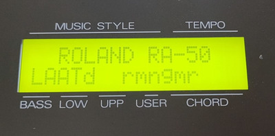

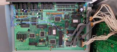

I have been fighting with this mod for a while now but I cant get it to work. I would really appreciate some help.
The problem im having is that when I have the mod (with switch) installed I only get the "MT-32 mode" working. I get the "LA Sound Module is not present !" message on the display and it sounds great.
But when i switch to Normal/Arranger mod i get corrupted messages on the screen and no sound output. I have attached a couple of screenshots. It almost looks like assembly. "LAAT ..", "LART" and so on.
When I remove the mod it works fine in its normal state. I have resoldered everything a couple of times. I have checked continuity with the DMM. The switch connects 1-2 or 2-3. The cut trace does not show continuity (10 Megaohm). None of the connections are going to ground.
ahyeadude wrote on 2023-03-04, 19:40:
Success! Thanks all. Using a pin on the MC68 was easier and probably more stable than soldering to a via or trace. Not sure which pin number it is, but it's easy to find with a multimeter.
I dont seem to have a connection to the MC68 from the cut trace, could this perhaps be an issue with the revision of my board?
Hopefully it's just a rookie mistake but im stuck.
Edit. Good news! I got it working. And it was a rookie mistake indeed. My first instict was to remove my post but i will leave it up if anyone makes the same mistake. I'm putting the solution in a spoiler but the problem is visible in the 3rd picture for those who are familiar with this modification.
Spoiler
Measure twice and cut once. Yes I cut the wrong trace... 🙄 Good thing Roland built this thing like a tank.

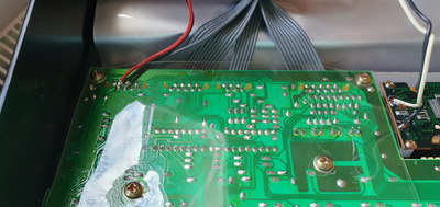

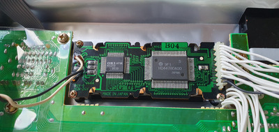

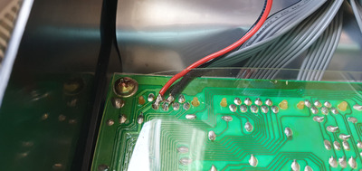

Thanks a lot! I bought and modified my RA-50.
Installed a display from Roland D-20 (using 5mm M2 PCB plastic spacers). I took +5V for the backlight from the connector on the control panel.
