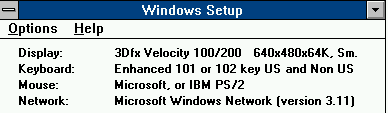

First post, by red-ray
I just installed Windows for Workgroups 3.11 and thus far I have only managed to get my Voodoo3 2000 to run at 640 x 480, but on Windows 2003 Server it happily runs at 1600 x 1200. Has anyone managed to get a Voodoo 3 running at higher resolutions or know of a VGA card that will please?

    Only 640 x 480

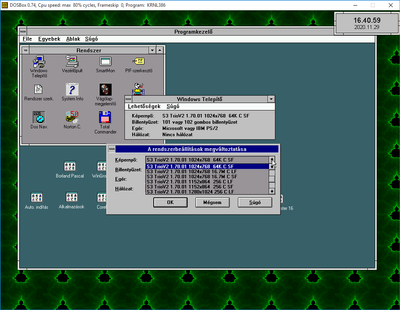

Hi, It's hard to believe that only 640x480 drivers can be installed for your card. Have you checked the available drivers under Windows setup? BTW S3 Trio/Virge cards definitely have drivers that depending on video memory size enable you to use even 1280x1024:

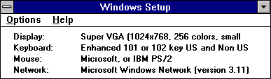

Thank you guys, I used the patched SVGA driver and now get 1024 x 768 @ 256 colours which is good enough for me.

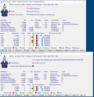

Next I need to find a version of the MSVC 6 MSVCMON.exe that contains the relocation information, the only one I have is linked /FIXED (.reloc missing) and I need one that's linked /FIXED:NO otherwise WIN32s won't run it. I just built a SIV32O.exe with /FIXED:NO (.reloc present) which now seems to start running, but it does not get very far at all so I need to get the debugger going.
    2.38 KiB
    588 views

Thank you, it says Do not use Microsoft Visual Studio 6.0. WHY? See BELOW! so basically it looks like I would need to use MSVC 5.0 which I don't think I wish to do.

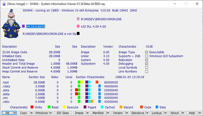

Thank you guys. I did some checking and MSVCMON 5.0 does not have the .reloc section so won't run, but MSVCMON 4.1 (4.2 comes with this) does so should.
file.php?id=97395file.php?id=97394

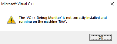

To check if I could use MSVCMON 4.1 with MSVC 6.0 I ran it on 2003 server, checked what happened and it did not work so suspect for remote debugging to work with WIN32s I would need to use MSVC 4.2 on the host system 🙁.
file.php?id=97393
Finally I tried MSVCMON 4.1 on WIN32s and when it ran it failed to offer TCP/IP when on 2003 it did 🙁.
file.php?id=97396
Given this I am even less inclined to try using MSVC 4.2 🙁, but wonder if any of you get TCP/IP offered on WIN32s so attached the MSVCMON 4.1 from the MSVC 4.2 CD.
