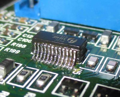

Old chip vs new chip

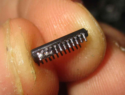

The general process consists of straightening the pins of the new chip, I have used a screwdriver against something hard to push the pins straight. You need all of the straightness possible because the pins barely reach the original chip even when maximally straightened.
You also want to tin up the pins of the new and old chip or you'll have hard time getting the two connected. Use as much flux as necessary and don't worry about solder bridges, they will contain enough solder to fill in all the cracks and make good connections.

Tinned up pins, with a blob
Once all the pins are tinned you'll line up the new chip on top of old and run the iron over the pins (when you have fluxed them up more). The solder in those bridges will drag with the iron and fill in all the gaps between the chip pins, making good connections. You can wick away excess solder with desoldering braid or simply get it transferred to the iron's tip and remove it that way. I generally do it without the braid as it can suck away too much solder and you must apply some more to get connectivity between the chips...

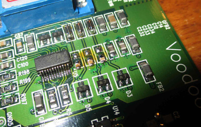

There's also a bonus feature possible, many cards have inductors and capacitors on the RGB lines to reduce EMI but they are tuned to low resolutions and will muck up the image slightly. Getting rid of the capacitors and bypassing the inductors will let you have cleanest possible signal :
177.03 KiB
2173 views
No more output filter !

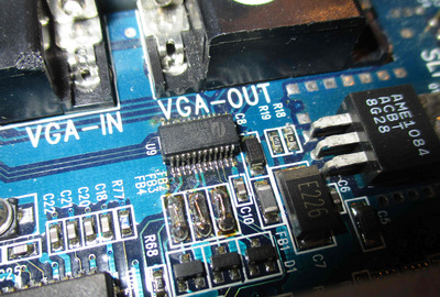

Here's the mod done on a Voodoo2 :

Voodoo2 mod
