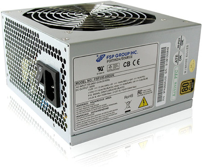

Reply 5 of 16, by RandomStranger
I generally use FSP PSUs whenever I can. They are cheap and reliable used by many reputable OEM companies for their work stations. For your PC I'd go for something around 300W. Even that has twice the output you would need.
For used PSUs I lean towards Seasonic, FSP and Delta Electronics.

Reply 11 of 16, by Socket3
Any 80+ power supply, even a 350w will work great. I use refurbshied FSP group and Delta Electronics 80+ bronze and 80+ gold (depending on model) in most of my pre 2005 computers.
You don't need to go and buy an expensive 600w corsair PSU for such a machine, the athlon 64 3000+ and gf4 ti barely use any power compared to modern machines, and going overboard on PSU output means it will not run in it's optimal load scenario witch leads to a (insignificantly) higher power bill.
One great thing about FSP and Delta Electronics PSUs is that most of these OEM models have rather strong 5v rails making them useful for socket A rigs, and others (older 200-250w models) even provide -12 and -5v, great for older builds with ISA slots running an ISA sound card (some sound cards require -5v and or -12v rails). Just make sure you buy one that is 80+ certified, as older non-certified Delta Electronics units are known to be unreliable.

Socket3 wrote on 2020-12-02, 08:29:
Anything beyond the nominal 10 year lifetime, especially if it's hard use, can be unreliable, but no Delta models I'm aware of in the last 25 years suffer any design flaws which make them more problematic than others. You're also recommending features which are largely contradictory. Delta adopted ATX12V 2.x power distribution fairly early on most of their models as the bulk of their PC power supply work is in the OEM and server markets powering Intel hardware. Heavy 5V rails were a requirement of 32 bit Athlon motherboards except the odd few which generated core voltage from the 12V rail, but Athlons weren't really popular in the OEM sector. The first 80 plus rated power supply came out at the start of 2005, well after ATX12V 2.0 was released, which makes finding an 80 plus rated Delta PSU designed to the ATX12V 1.3 (or earlier) standard difficult to impossible.
Reply 14 of 16, by Socket3
gdjacobs wrote on 2020-12-02, 15:43:
I specifically mentioned refurbished. The PSUs I get have had all capacitors replaced with panasonic caps, regardless of the PSU brand. I checked several FSP, delta and other brand of PSUs, they have all been recapped with low-ESR panasonic caps. That brings reliability up a little bit.
As for Delta PSUs, alltough generally very reliable, have had problematic units specifically in 2005-2008 HP OEM PCs, but also some older 1998-2000 eMachines computers. Most of the failures we saw back in the day regarding these PCs were PSU related, and the PSUs were 250w delta electronics units.
