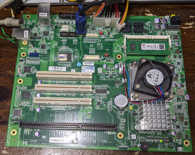

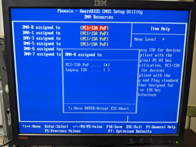

Reply 82 of 113, by cyclone3d
According to the BIOS, it supports ISA DMA:
645.86 KiB
1494 views
454.4 KiB
1494 views
It doesn't have a floppy controller so I can't hook up my test CF card. I wonder if it can boot from a usb floppy. That would be nice and make it a lot easier to set it up for testing. Once I clean up the other project I am working on, I'll do some tests with this board.
