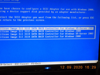

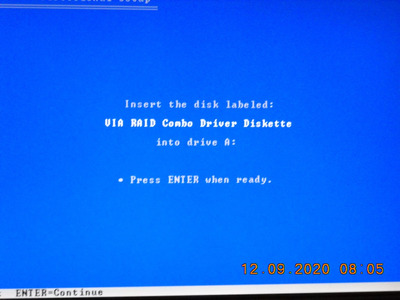

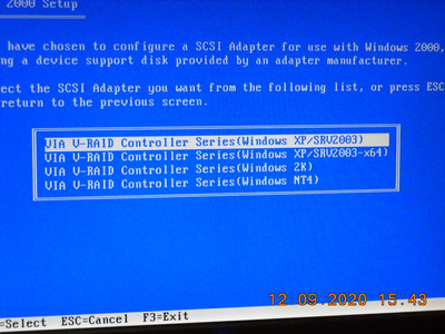

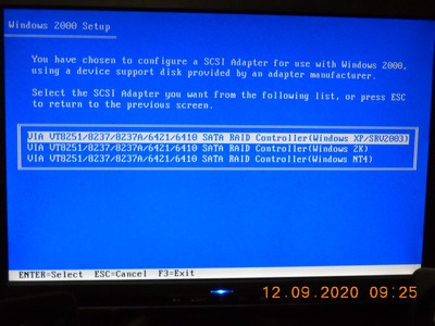

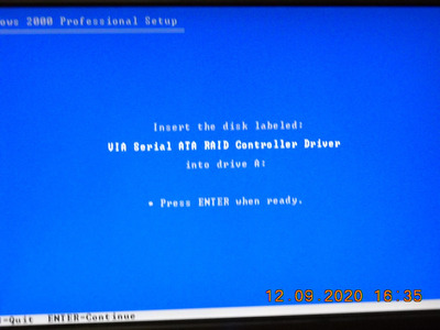

I'm stuck and the best way to explain this is with pictures. So i hit F6 as soon as Win2k starts just like in XP and this is where i'm at. I have downloaded drivers all over the place and tried the kitchen sink. I have read threads here and all over the net for the last 4 days. I am truly at a loss on this one.
This is a bastardized board and i also know that the drivers say VT8237A in the picture. So i'm now wondering in all the drivers i have downloaded did one actually say VT8237 only? err
    132.09 KiB
    1057 views
    Win2k rolls on then gets stuck here after i fed it the drivers.
    159.14 KiB
    1057 views
    So here they are direct from the floppy
    166.19 KiB
    1057 views

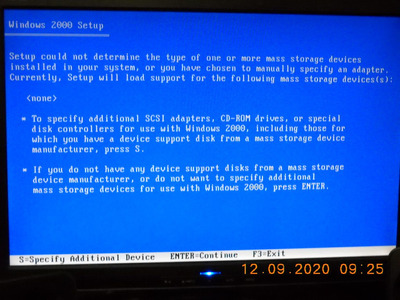

    Ok Win2k wants the drivers cool

Reply 2 of 22, by Dmetsys
Are you using the drivers that would have come from ABit or VIA? There might be a missing Hardware Vendor ID in the drivers' inf file.
http://abit.ws/page/en/motherboard/motherboar … PRODINFO=Driver

Reply 3 of 22, by script-fu
The VIA SATA Driver v4.30g: Yep extracted that .ini and put it on it's own floppy & nada. Then i put it on the floppy you see in the pictures & nada.

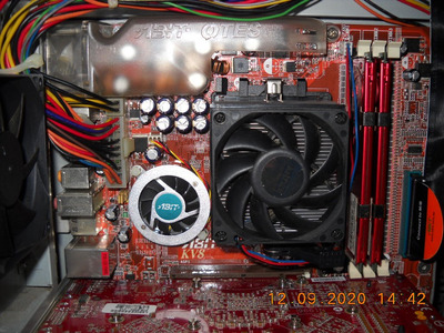

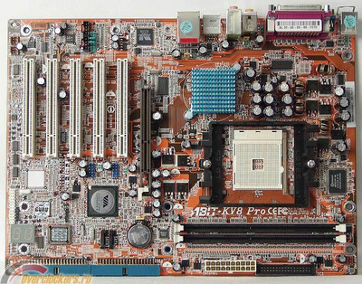

Reply 4 of 22, by script-fu

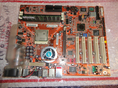

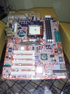

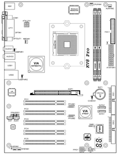

Let me explain a little bit more. I have a bastardized board direct from ABIT. The mobo is actually a KV8-MAX3 so the Northbridge is a "K8T800". However my mobo does not have the sata controller at the bottom.
If you look at the KV8 PRO it has the "K8T800 PRO" Northbridge.
The boards have different NB's. Does that make a difference? IDK but i have tried all the MAX drivers too. I have used the drivers from Vogons Drivers, Phils Computer & ABIT. I have tried drivers from CNET and random places around the net.

    KV8 PRO from eBay
    322.23 KiB
    1038 views
    KV8 PRO Scatt

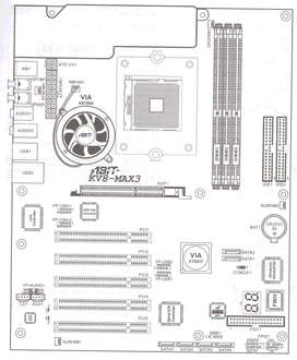

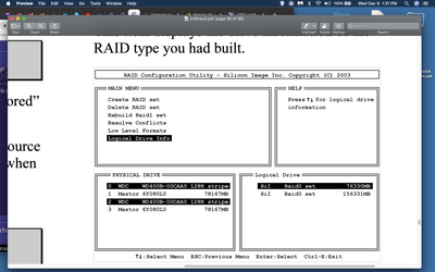

Reply 5 of 22, by script-fu
Here is a snap of my onboard RAID. Notice it doesn't say SIL in the panel? Like this other snap whicj is in the KV8-MAX3 manual?
    909 KiB
    1035 views
    KV8-MAX3 RAID from the manual. However thats not what i have onboard.
    155.13 KiB
    1035 views
    This board is crazy it should have the SIL RAID

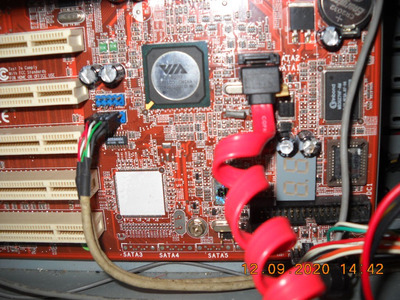

My mobo
    199.63 KiB
    1024 views
    Southbridge no sata controller?
    210.8 KiB
    1024 views
    See it's a ABIT KV8 on a KV8-MAX3 PCB

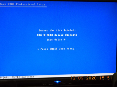

Reply 9 of 22, by script-fu
Choked again
Would my hard drive effect this install procedure on Win2K? It's 250 GB Maxtor SATA1 and it's all in one partition.

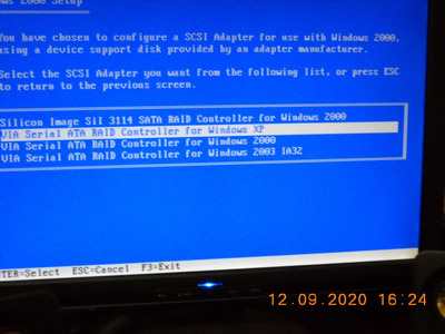

Reply 11 of 22, by script-fu
When using the Sil drivers Win2k said no hard drive found.
    139.83 KiB
    986 views
    Same deal
    152.29 KiB
    986 views
    I tried the VIA's that were combined
    157.32 KiB
    986 views
    Ran both Sil 3112 & 3114 w/no joy!

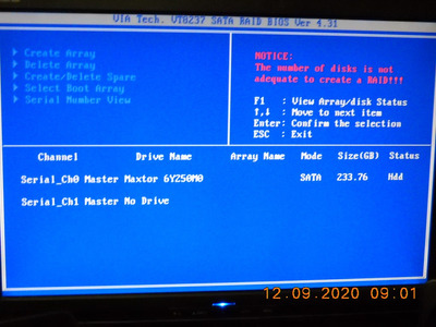

Reply 12 of 22, by Dmetsys
What is the controller mode to set to right now? Some southbridges will disable IDE ports, once the S-ATA ports have been assigned as Primary/Secondary ports. Then it will be seen as a standard IDE device.

Reply 13 of 22, by script-fu

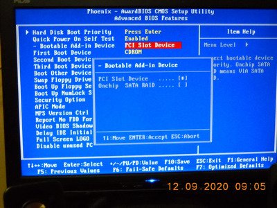

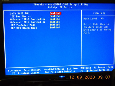

I have had them set 7 ways to sunday. Here are the two settings below.
When i have both RAID setting toggled on. I can get into the secondary VIA RAID BIOS. When I have just the SATA RAID rom on same deal the VIA RAID shows at post and can be accessed by hitting the TAB button.
now
If the SATA RAID rom is off and the ONCHIP SATA RAID is toggled on the VIA RAID BIOS goes away. I truly believe this is the correct setup. So the SATA drive can be emulated as a IDE drive. If you know what i mean.
    160.1 KiB
    928 views
    SATA RAID ROM
    176.41 KiB
    928 views
    ONCHIP SATA RAID

Reply 17 of 22, by Dmetsys
script-fu wrote on 2020-12-09, 23:02:
Yep the floppy drive is a brand new Sony USB. It works flawless across all my other PC's.
Cha-ching, there is your issue right there. XP and 2000 Pro can't copy files from USB devices while you're in text mode setup. The floppy drive either needs to be a floppy emulator eg: Gotek, or a physical 3.5" floppy drive that is plugged directly into the floppy connector. If someone barks up that it is supported, then that comes down to motherboard. Personally, I have never had it work with any motherboard that I paired with 2000 Pro or XP.
If this is not possible for you, I would recommend slip-streaming the RAID drivers into the 2000 Pro install CD. If you don't have SP4 media, I would highly recommend slip-streaming that in as well. Some, but not all drivers may have Service Pack requirements.

I have regular ol floppy drives here. So i will plug one in a give it a shot. It does have the setting in the BIOS tho and keys right up. At this point it wont kill me to grab a regular floppy. I have them all over the darn place.
I found this on slipstreaming 2k but im not sure if i can go right to SP4 or not so any ideas on that Dmetsys?
https://www.techrepublic.com/article/create-a … -service-packs/
Thanks!!!

You can go straight to SP4 without any problems. DO NOT slip-stream the unsupported 5.1a Service Pack. That one was compiled by third-parties, and should be installed manually after SP4. If you are looking for media that already has SP4 built in, you can acquire it at REMOVED
