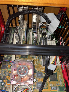

Got many of the parts assembled today.
Still waiting on some things
It’s been a pain trying to figure out how to get an os on it after discovering my only ide cd drive appears to be bad and not being able to boot from usb

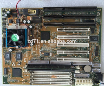

Reply 44 of 120, by Sphere478
Deksor wrote on 2021-01-23, 14:34:
You haven't made a photo of the motherboard ? 🙁
other one is of one from internet.
Sphere's PCB projects.
Reply 46 of 120, by Sphere478
Deksor wrote on 2021-01-23, 22:32:
I need one like the first one but without the big watermark.
Oh is this for the database?
Shoot, um, I’d have to take it all apart. Sorry, I didn’t remember you needed it. If I get it out again or run across one I’ll hook you up 😀

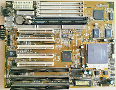

Meanwhile, after paying closer attention to the photos I noticed the "Iwill" logo in the silkscreen of your motherboard. So the brand is confirmed (but I'd still like a nice photo from you 😀 ), I have added each BIOS I could find here http://www.win3x.org/uh19/motherboard/show/4311
If your board has a older bios, please back it up and send it to us (you can use uniflash for that). You can probably update your motherboard's bios too since the latest version is from mid 1999.

Reply 52 of 120, by Deksor
Well Jan's bios is based on the 1999 bios. So I guess his bios is better ^^ (I have added it too).
I don't know how these bioses are patched but to my knowledge adding USB boot would require some more in depth patching than adding CPU support.
You can use anything (by putting it on a floppy disk, a CD-Rom, from the network ...) with "plop boot manager" to achieve USB booting though, but it's not direct booting.

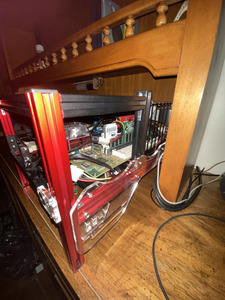

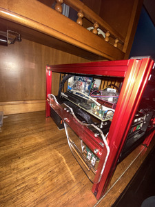

Getting system to boot.
update. got around issue with being unable to boot to anything
yes, good point about the boot manager. that can work
I may be able to get you that bios soon. stuff seems to be working. lots of stuff to do though.
I have the k6 set to 200 setting on motherboard which in my notes should be 75x6 450
but in the bios just like old notes it says 66 mhz 🤣. i'm sure my notes are correct
if i haven't mentioned it, I'm running at 1.5v core right now without any jumpers installed so far seems stable the 2.2v option also seems to work but I have opted for 1.5 as some releases of this chip were clocked lower and set to 1.6v
this cpu can probably be run without a heatsink nearly 🤣 but don't do that haha a passive heat sink is more than enough for it. but of course I am running a copper p3 cooler with fancy leds haha
latest update, I have successfully booted to a windows xp live cd

got some stuff for ya! haven't gotten to the bios yet.
pic is not of my personal board but rather V1.2 mine is 1.23 I noticed fan headers change from board to board haven't noticed anything else. note two pin header by cpu and three pin header near middle front
the usb header pin out took a while to figure out, I think there is ps/2 in there also I made a diagram I hope it helps someone else someday
gonna work on the bios now
