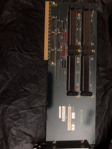

Additionally here is the Micronics M810 memory card, which provides an additional 32MB via Bank2 and Bank3. 64MB system total. You may also use this photo.

Reply 67 of 68, by Keatah
One other brief note. Your site lists the optional numeric processor as a 3167. This is a 486, so it would use the Weitek 4167..
Many years ago I saved this from this: http://support.mpccorp.com/tech_support/MOTHE … 3/00000005.html
Last Modified: 11/15/2003, Author: TCM, Revision: 1.01
Chipset
4000053,GEM486-33,GEM486-33F
