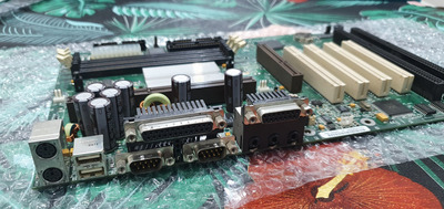

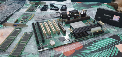

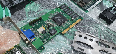

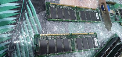

Update 06/19/21:
Finally today my new motherboard has arrived, I leave some images for you to see.
The state of conservation is amazing. The mother came with several boards (video, network, ram, etc). It also came with a PII 333 , I'll see if I can change it for a 450.
On these pieces I will decide which one to leave since I am going to try to put together the best configuration for 1998.
Ahora ire por la placa de video y creo que las noticias son mejores de lo que esperaba, tan pronto como lo pueda confirmar se los contaré
Cheers!

Hello World!, this is my first post!,
I am thinking build a mid 1998 machine with a pentium II. Currently where I live I have the following models available for immediate purchase:
  • Intel: Se440bx-2
  • Soyo: SY-6BA+
  • Soyo: SY-6VBA 133
I would like to know which of these mothers do you recommend and why?
And finally, what is the best for me? a PII of 333mhz or 400mhz. My idea is to run games and apps until 1998, including games in ms-dos.
Thanks in advance.
