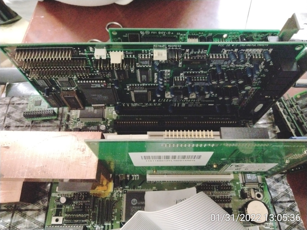

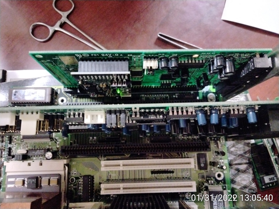

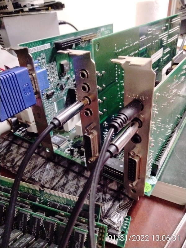

More stuff I did. Testing a dual sound card setup: Yamaha OPL3-SAx for SB, MIDI and OPL3, and a Primax Soundstorm GUS clone for GUS compatibility. Seems to work fine.
The output of the GUS is connected to line-in on the Yamaha, and the output of the Yamaha to speakers.
The Yamaha card has a Dreamblaster X2 attached. This way I have the best of all worlds. 😀
You can see in the 2nd pic above that the Primax has had its memory upgraded to 1MB.
I've also disabled everything on the Primax except for the GUS synth. No SB emulation, no OPL emulation, no joystick, no useless CD ports.

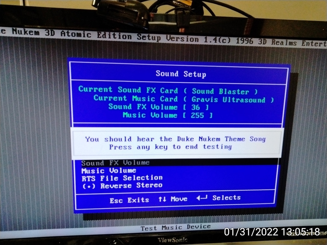

It's weird that Duke3D doesn't like the GUS to be on an IRQ above 7 and complains about it. I had initially the Primax set to IRQ11 and it was working fine but Duke complained so I moved it to 7. Meh.
Yeah, some games are fine with using higher IRQs for GUS but others (Duke3D and Rise of the Triad come to mind) just refuse to work with IRQ > 7, it's pretty annoying when you have several sound cards in the same PC and need to juggle with all the IRQs.
