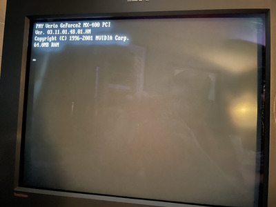

Is there a Detonator driver that gives comparable Ditect3D performance for an MX400 that a Voodoo2 might have on a POD/UMC combo?
I’ve got a PNY MX400 posting and booting into Windows with an AMD 5x86. I can get GLQuake to run but no Direct3D as feipoa mentioned in this thread. GLQuake score was 26.5 no sound.
Switching over to a POD things get unstable. I can run Turok but the frame rate is quite miserable, in the low teens. Was only able to run one GLQuake demo and scored lower than the AMD at 25.5fps. Other attempts see GLQuake freezing with some graphic artifacts.
Both these results were on 12.41. I tried 77.72 Final on the POD but can’t boot into Windows. Not expecting miracles 🤣, just curious of anyone has tried.

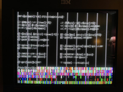

Agreed, my POD runs stable across multiple socket 3 boards, it’s when I combine it with the MX400 that I start experiencing system hangs. even right after memory test. I’ll test the MX400 on my slot 1 machine next to be sure it’s functioning properly.
Below is a pic of me trying to start the dosbench quake demo and immediately the system freezes with video corruption.

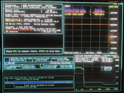

I can confirm a Voodoo 4 will not post on either a Lucky Star LS486e-C2 or a Biostar 8433UUD-3.1.

Yes the Voodoo3 board runs quite well on the my LS486!
Also just discovered in Direct3D you can choose resolutions lower than 512 with the Voodoo3, this might open up a few more games to be playable on socket3/486/SiS with a voodoo.

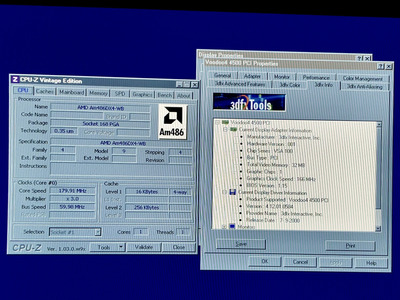

I managed to get a Voodoo 4500 working on a LS486 Rev D. It wouldn’t post on Rev C2. GLQuake is working but seeing some weirdness with Direct3D. The DXdiag tool for instance throws an illegal operation and MotoRacer loses video shortly after starting. DirectX 7 is currently installed.
*I think the Direct3D weirdness is a power supply issue, as long as I don’t have a CD in my drive Direct3D games are running fine now.
