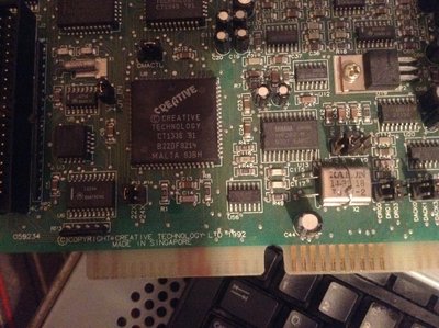

I have isa soundblaster pro 2 in my dos Pentium 1 machine and most games play and sound fine with no issues but there are games where the sound is garbled or starts ok then goes garbled and sound like white noise and wondering what is wrong and if I can fix it
the games that this happen to so far is
Are You Afraid of the Dark : The tale of Orpheo's curse
The Terminator (Bethesda 1990 version)
Reply 1 of 68, by keropi
Most likely the system is too fast and those games crap out because of their programming. Use a slowdown utility or one to disable caches and the issues will go away.

I checked again with my SB2.0 and indeed it is very sensitive to the bus speed and sometimes disabling L1 and L2 is not enough, because the bus speed is still the same.
Prince of Persia 1/2 FM music is known to scramble with the older SB cards on a Pentium.
What board revision number do you have (bottom left corner), and does it have a 14.318 Mhz oscillator on board?
Here are some old links about that:
Sound Blaster Pro - speed sensitive?!
Re: Sound Blaster Pro 1 and Prince of Persia
The Adlib, SB 1.0, 2.0 and SBPro1 lack an oscillator on board and the YM-3812 OPL2 chip is extremely speed sensitive, much more than the OPL3.
By my book, it is another black point to the SBPro1 CT1330A, its basically useless in a Pentium. 😵
Reply 8 of 68, by Robhalfordfan
Here is pics of card
    1.36 MiB
    651 views
    1.47 MiB
    651 views

Reply 12 of 68, by Jepael
James-F wrote:
This is the same as?: http://www.pcguide.com/ref/mbsys/bios/set/adv … ecov8Bit-c.html This didn't help. […]
This didn't help.
Interesting why some games are more sensitive than others, testing with SB 2.0 as it is extremely sensitive (OPL2, no Oscillator).
DOTT was fixed with L1, L2 disabled (very slow) and CPU at 133Mhz but it was still scrambled on 233Mhz with both caches disabled.
I will test with a non MMX...
EDIT:
Nope, non-MMX at 100Mhz did not fix the scrambled FM with the SB 2.0.
I still had to disable L1 cache and sometimes both (DOTT) for the OPL2 to sound right.
I put back in the SBPro2 CT1600 and everything is fine, except DOTT which still needs L1 disabled (only).
I don't have a 486 to test it on but I can tell that on a Pentium the SB 2.0 (can't speak about SB1.0 and SBPro1) is completely useless when it comes to FM music.
OPL2 needs longer delays so it's the first one to break, it's not even hard to break it. But breaking OPL3 requires things to go seriously wrong to begin with, if a game meant for OPL2 does not work even on a OPL3 when used in fast machine.
Yeah, well games are coded badly so that on faster systems they are not able to write slowly enough to the card and the music breaks.
Lucas uses some kind of calibration loop but apparently it does not scale well for faster machines (I recall there were patches to fix DOTT).
It could be just a standard case of delay value rolling over a variable or something.
Nothing a quick hex editing would not fix.
Reply 13 of 68, by Scali
Yup, from a practical point-of-view it is. But it really is just a software problem, not a hardware problem. And it can be fixed. I've patched the broken code in the Crystal Dream demo, for example.
