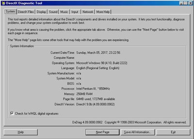

And here is the DirectX information:
System Information
Time of this report: 3/5/2017, 23:30:05
Machine name: *************
Operating System: Windows 98 (4.10, Build 2222) A
Language: English (Regional Setting: English)
System Manufacturer: n/a
System Model: n/a
BIOS: n/a
Processor: Intel Pentium III, ~850MHz
Memory: 256MB RAM
Page File: 68MB used, 1723MB available
Windows Dir: C:\WINDOWS
DirectX Version: DirectX 9.0b (4.09.0000.0902)
DX Setup Parameters: Not found
DxDiag Version: 4.09.0000.0902 32bit
DxDiag Notes
DirectX Files Tab: No problems found.
Display Tab 1: The file s3_7.drv is not digitally signed, which means that it has not been tested by Microsoft's Windows Hardware Quality Labs (WHQL). Current drivers tested for a WHQL logo are only available on Windows ME, Windows 2000, and Windows XP. New Windows 98 drivers are no longer tested for WHQL logos.
Sound Tab 1: No problems found.
Music Tab: No problems found.
Input Tab: No problems found.
Network Tab: No problems found.
DirectX Debug Levels
Direct3D: 0/4 (n/a)
DirectDraw: 0/4 (retail)
DirectInput: 0/5 (n/a)
DirectMusic: 0/5 (n/a)
DirectPlay: 0/9 (retail)
DirectSound: 0/5 (retail)
DirectShow: 0/6 (retail)
Display Devices
Card name: S3 Inc. Savage/IX w/MV
Manufacturer: S3
Chip type: Rev E
DAC type: Internal
Device Key: Enum\PCI\VEN_5333&DEV_8C12&SUBSYS_80BA1033&REV_13\000800

    directx first image

Mobile Pentium 3 Coppermine can change frequency on the fly. I have HP Omnibook 6000 (which is also Intel BX based) with mobile Pentium 3 1000 which can slow down to 700Mhz.
Don't remember if it is multiplier or FSB lowering. I think it is early implementation of SpeedStep technology which is not well supported after Windows 98.
Of course I can be wrong. It was quite a long time ago when I was fighting with this beast, and my memory may fail.
If I can suggest something - try to download driver pack for HP Omnibook 6000 from HP support site, and check if it does contain specific driver/update for this CPU feature.

yes Pentium 3 already had Speedstep. I want to say the Dell P3 laptop I had did show varying CPU speed in software because of that but I guess I have to say that my memory isn't 100% clear on that, and I could be remembering incorrectly. But P3 mobile does have Speedstep for sure.

Run an instance of Prime 95 while running CPU-Z to be sure Speedstep is not slowing it down.
