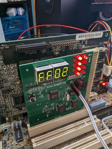

So I bought an Asus P2B and a P3B-F. Sold as unkown working status. They arrived yesterday.
And... of course they don't work.
The P2B was easy to diagnostic. The MOSFET in Q10 is missing on the top. Yeah I didn't notice in the seller photos.
Does anyone know the exact component?

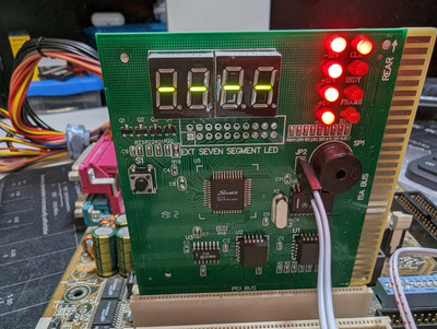

The P3B-F is whole another story. It doesn't do anything with the CPU plugged in, not even a beep.
1.72 MiB
1376 views
With the CPU removed the speaker does a reapeating pattern of LOW and HIGH beeps, which means and I quote "Either the CPU is not seated properly or the CPU is damaged. May also be due to excess heat. Check the CPU fan or BIOS settings for proper fan speed."
What I have tried so far:
  • two PII 350Mhz CPUs. Tested also JumperFree mode.
  • different RAM modules or none at all.
  • two know good PSUs.
  • flashed different BIOS versions. Now there is this one.
  • new CMOS battery.
  • cleaned CPU slot edge connector.
Another maybe interesting detail, I tried still with a video card and my KVM switch doesn't turn on at all. That KVM even without a proper video signal it turns on when it is plugged to a powered on video card.
I don't see any physical damage but I know that caps can go bad without any visible defect. Before going down the road of recapping the full thing, is there something else that I can check?
I know that they are really good motherboards (when they work) so I really want to try to get them fixed.

Reply 1 of 38, by Zerthimon
Try this: set the jen jumper to a jumperfree mode, then connect only the CPU, power it on, then after one minute check if anything is getting hot on the board (both bridges, Asus (monitoring) chip, winbond (sio) chip) etc.
Reply 2 of 38, by mrfusion92
I am speechless...

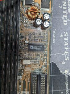

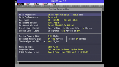

I was doing what @Zerthimon said, while touching around all the chips... the motherboard started POSTing under my eyes.
Powered off, plugged RAM and video card.... and I was able to go to the BIOS and even boot my bench DOS CF card.
1.21 MiB
1351 views
1.17 MiB
1351 views

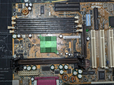

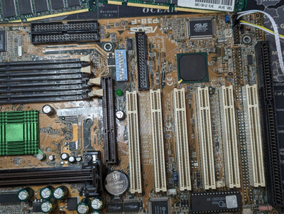

I think it started POSTing after I touched\pushed this chip, which I think is the clock generator. It also gets hot, is it normal?
No other chips got too hot, only that.

Reply 5 of 38, by mrfusion92
And indeed after a couple of hours while I left the motherboard disconnected I'm back to square one with zero signs of post.
The clock chip gets very hot, I can't leave my finger on it more than 3 seconds. This also while it was working.
I'm not so good with the desoldering. Like I did a small recap in a Pentium 4 motherboard, it works now but desoldering the caps was a nightmare for me.

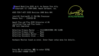

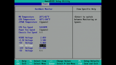

But I've noticed this now, it gives me this hardware error which I've ignored so far thinking it was because of the missing floppy disk drive .
450.76 KiB
1228 views
And the error is about the 12v rail. I disabled the monitoring of it and the error got away. Tested two PSUs and reading was about the same. The voltage read out got from a molex with a multimeter is in spec.
How can I know which caps are on the 12v rail?

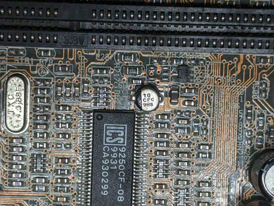

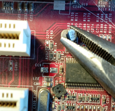

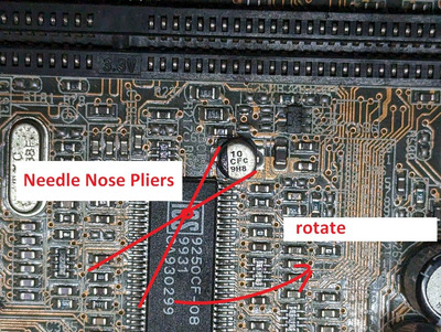

verysaving wrote on 2023-06-03, 00:41:
Try replacing the tiny smd cap near the clock generator.
Bigger caps seem to be Rubycon and Sanyo and they age
usually well if not thermal stressed.
Oh god that tiny little cap? If I try to remove it I will end up ruining this motherboard even more. Besides I can't understand the values of it.

Reply 8 of 38, by Horun
Appears to be a Panasonic Alumimum cap. 10uF 16v SMT. The 10 is for 10uf, CFC is voltage/series. first letter is voltage, C for 16v, FC is the series. Bottom stuff is the lot.
From this pdf: https://www.farnell.com/datasheets/2813661.pdf and this for a 10uF 50v: https://ph.rs-online.com/web/p/aluminium-capacitors/0568777

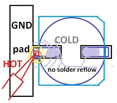

#1 Never try to desolder the SMD electrolyte.
#2 Never try to solder smd electrolyte without heating from below.
Use SMD tantalum capacitors or MLСС

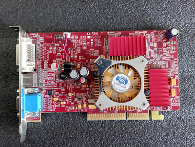

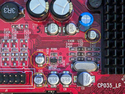

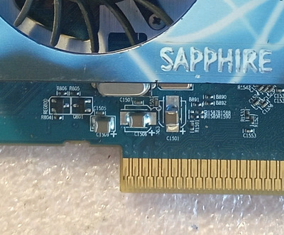

For example, Radeon 9xxx, which does not work, not only look good on the shelf, but also serve as a source of SMD tantalum capacitors 10-22uF 6.3-16V.
I do have a Radeon 9200 which shows artifacts with probably bad vram chips! And indeed seems to have three 10 uF caps but I think that they are rated for 16v. Is that an issue?
1.45 MiB
1090 views
However, the fact remains that I am not equipped for this type of work. I will probably need at least an hot air gun.
Reply 13 of 38, by shevalier
mrfusion92 wrote on 2023-06-04, 13:45:
This will show only the replacement
You can't solder them with a soldering iron, see picture.
Hot air gun - overheating.
Finally use MLCC, the 21st century is ending...

Reply 16 of 38, by shevalier
Everyone says WUT.
But not everyone shows results.
The photo shows a complete reflow of solder at the factory, and not 1 mm of snot.
