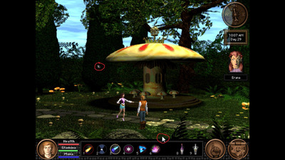

Reply 93 of 237, by KainXVIII
Dege wrote on 2021-12-12, 16:32:
KainXVIII wrote on 2021-12-08, 08:04:
Thanks for new release!
PS - i have a question about integer scaler in dgv, for example when i tried it in Quest for Glory 5 mouse cursor become unusable/misaligned, any way to fix this??
And this is only an issue with integer scaling? Isn't it with, say, a plain resolution forcing?
I only tested integer scaling in QFG5 without resolution scaling (unforced in settings), i don't know what i changed but now cursor is acting like normal but its smaller copy is still showing sometimes 🤣
PS - don't mind the resolution of the attachment (its actually in 2x integer scale), its just how i capture it with shadowplay..

Actually, the cursor indeed does not appear at the expected location with integer scaling...
I've just run into it, and fixed.
Reply 98 of 237, by KainXVIII
Dege wrote on 2021-12-20, 15:37:
KainXVIII wrote on 2021-12-12, 18:20:
I only tested integer scaling in QFG5 without resolution scaling (unforced in settings), i don't know what i changed but now cur […]
Excellent! 😤
