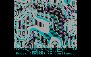

I got DEBUG.EXE, but I'm trying to figure out how to write 03h to port 61h.
I'm trying this in debug:
-o 61h 03h
but I get an ^ error pointing at the H
EDIT:
I tried
debug.exe
-o 97 3
https://beausanders.org/ascii.htm
03h = 3
61h = 97
and WILD.EXE is still giving the malformed topo map generation
Sorry about that, DEBUG accepts hexadecimal without the 'h' suffix.
It should be:
o 61 3
It should immediately cause a BEEEEEEEEEP but it also turns on the clock gate for PIT timer 1 (tied to PC speaker) which may help the game work.

Codeholio, trying DEBUG 0 61 3 didn't work; but I found something that did.
After some trial and error; I narrowed it down to:
fpu = false
If this is set, the topo map generates correctly.
If it's set to TRUE, it generates the error I posted earlier.
This makes me wonder if WILDERNESS also had the same problems if an actual FPU was installed on actual hardware, since back then; the 8087 FPU and later the 287 and 387 FPUs were quite rare.
EDIT: Is it possible to add a config file setting for monitor hue presets to DOSBOX-X? Reason I ask is that in the WILDERNESS manual is this line:
We suggest you use a color monitor or television to more vividly recreate nature. Make sure the tint is adjusted so that the sky is blue and the world appears in its proper hues.
Reply 2222 of 2397, by _Rob
@MKSheppard, if you used a Windows VS build, try a MinGW build of DOSBox-X instead.
Visual Studio (VS) has issues with the 80bit precision of the old FPUs.
I just tried Wilderness in DOSBox-X on Linux, which has no issues with the FPU precision, and it renders just fine. Here is a level 10 rendering:

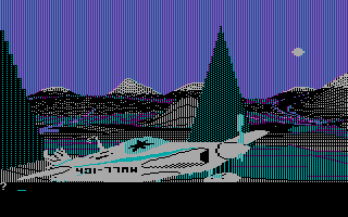

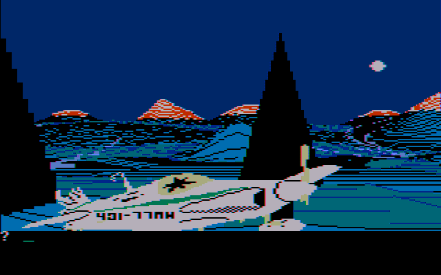

You can change CGA rendering in DOSBox-X. By default with ``machine=svga_s3`` you will only get 4 colour CGA. But when you specify ``machine=cga`` it will automatically use composite video when it auto detects that a game is trying to use it. This is just like with regular DOSBox.
But there are some additional possibilities with DOSBox-X with ``machine=cga``:
- You can use the CTRL-F7 keyboard shortcut to change between an early and late model IBM CGA adapter emulation
- You can use the CTRL-F8 keyboard shortcut to change between Auto, RGBI and Composite monitor output emulation
- You can use the CTRL-Shift-F7 keyboard shortcut to decrease Hue (may need to press it many times to notice the difference)
- You can use the CTRL-Shift-F8 keyboard shortcut to increase Hue

Ah, it's FPU precision. I assumed it was something with the PIT timer and randomization because something that old was unlikely to use the FPU.
VS2019 builds cannot do the full 80-bit precision except with dynamic core because Microsoft long ago (during the Win16 to Win32 to Windows 95 transition) decided that "long double" should just be "double". So there's no C++ compiler support for working with the full 80-bit precision, and that's why FPU precision is a problem there. GCC/MinGW still retains "long double" as 80-bit float and therefore no problems. Dynamic core is the exception to the rule because of the inline ASM used to access the FPU.
This is not a DOSBox-X problem but a problem for DOSBox SVN (which uses plain "double" anyway as far as I know) and all forks in general.

I can confirm that it is an issue with the Visual Studio version -- I just downloaded the 0.83.17 MinGW version and it generates wilderness topo maps just fine from the start.
You can change CGA rendering in DOSBox-X. By default with ``machine=svga_s3`` you will only get 4 colour CGA. But when you specify ``machine=cga`` it will automatically use composite video when it auto detects that a game is trying to use it. This is just like with regular DOSBox. But there are some additional possibilities with DOSBox-X with ``machine=cga``
Yes, I know. But having to use CTRL-SHIFT-F7/F8 every time I start the game to change the "monitor" hue is annoying, hence asking for a config file to preset "monitor" hue.
